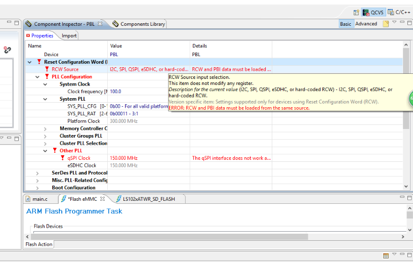

So my boot source is eMMC which is hard wired strapped.
Now back to RCW settings datasheet says
PBI_SRC 1110 is the IFC mode
Then IFC_MODE says cfg_rcw_src[0:8] 0_0100_0000  is SD/MMC (eSDHC) are multiplexed on
{IFC_AD[8:15], IFC_CLE} --------------------------------------> this is super confused
and this is also noted as 1 .Not valid as an RCW[IFC_MODE] encoding.

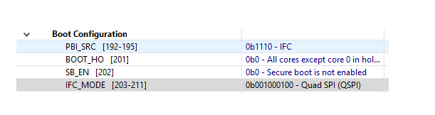

From my code warrior when I set PBI_SRC as 1110
the IFC_MODE does not have 0_0100_0000 this option at all.
(1)Can someone explains?

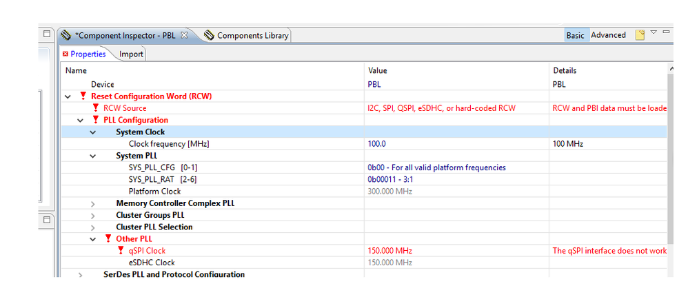

(2) Since I am using eMMC do I need to care about QSPI clock frequency ?
(3) I also have this error: RCW and PBI data must be loaded from the same source.
What exactly is confusing?
This is because IFC is not multiplexed with the SDHC interface.

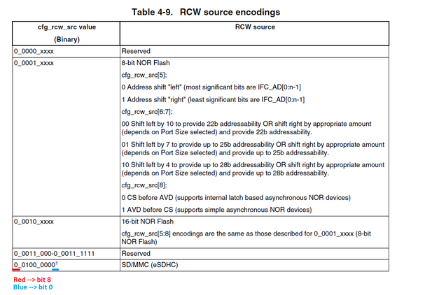

jiye
Contributor V

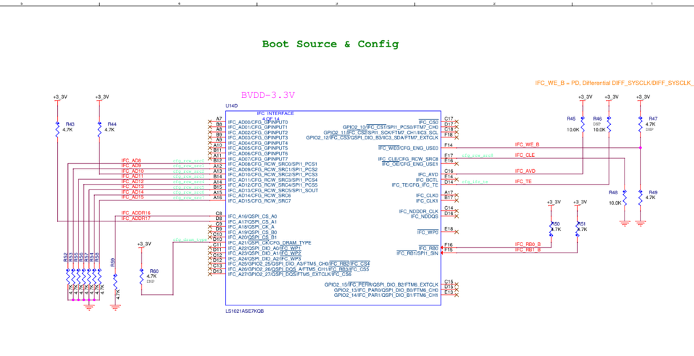

The confusion is  IFC_MODE says cfg_rcw_src[0:8] 0_0100_0000  is SD/MMC (eSDHC) are multiplexed on
{IFC_AD[8:15], IFC_CLE}  then what is IFC)MODE (these 9 bits for ) but I think you already answered they are not multiplexed on these registers
so if I need to set boot source as eMMC in the RCW what should I do ? Just strapped up the signals of cfg_rcw_src ?
Also can you look at (3) as well?
3,440 Views
ufedor
The shown strapping is not correct.
The "1" in the cfg_rcw_src[0:8] 0_0100_0000 corresponds to the IFC_AD10.
3,440 Views
jiye
Contributor V
(1) I think that is a mistake but before that I want to double confirm with you
Are you saying leftmost bit is bit 0 and rightmost bit is bit 8??

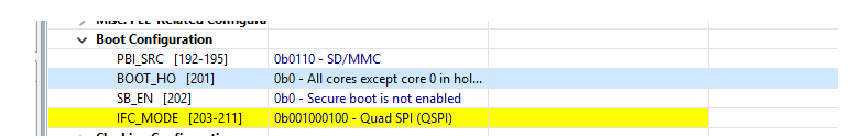

(2) what should I put in
PBI_SRC  0110?
3,440 Views
ufedor
1) Yes.
2) When PBI_SRC is configured for IFC, this field selects the IFC mode for pre-boot initialization.
The field setting is don't care if PBI_SRC is not equal 1110 (IFC).
3,440 Views
jiye
Contributor V
Does this match the boot requirement from eMMC?
3,440 Views
ufedor
This is OK.

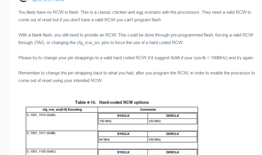

jiye
Contributor V
Hi ufedor,
I am facing JTAG detection issue so I found this thread LS1021a TAP Error
This is my eMMC strapping
(1) In order to make the hard-coded RCW works do I have to hard strapping these pins cfg_rcw_src[0:8] (like pulling down or up by resistors) then after I done I strap back to eMMC
(2) If not how this works by changing cfg_rcw_src[0:8] into 0x9A
3,440 Views
ufedor
1) Your understanding is correct.

jiye
Contributor V
is hard-coded RCW is the only option for me to bring a board up with empty eMMC and has no RCW in flash?
As this guy says
forcing a valid RCW through JTAG (is this can be done without cfg_rcw_src pins strapping) by just using CW?
3,440 Views
ufedor
It is possible to override RCW - refer to the CodeWarrior for ARMv7 Targeting Manual, 8.2 Using a JTAG configuration file to override RCW.
3,440 Views

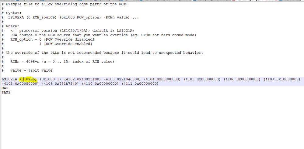

jiye
Contributor V
can you take a look at this config file
is the highlighted place should be (0 0x9b) or (1 0x9b)
this is the config file I am using for the hard-coded option
3,440 Views
ufedor
It should be (0 0x9b) - reference:
"\CW_ARMv7_v2019.01\CW_ARMv7\ARMv7\ARM_Support\Configuration_Files\jtag_chains\LS102xATWR_RCW_1000-300-1600.txt"
