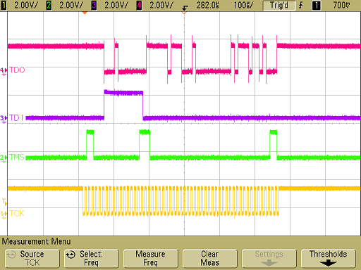

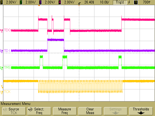

I made the comparison of JTAG signals. No answer so far. Wrong PCB returns random response, while the Tower board always returns the same response to the same request.
Here are diagrams of wrong response of LS1020A:
Here is the response of Tower board, which is always the same, and understandable by JTAG adapter:
TCK frequency in both cases is 1MHz.
TRST_B was reset just before capturing diagrams in all 3 cases.
So still no idea, what's wrong with the PCB...
Maybe a kind of security bits are on by default?
RTC has no 32kHz clock in my PCB. Maybe that's the reason?
Anything else can disable debug port?

alexander_yakov
LS1021A and LS1020A are based on the same silicon, so if your J-link works on LS1021A, than it should also work on LS1020A.
Please perform the following:
1. Please verify all power supplies are stable at their desired values, and power supply noise is as expected.
2. Please check TRST state. If TRST is connected to PORESET, please make sure TRST is asserted at least once at power-on, and than released.
3. Please look JTAG pins by scope for extra noise caused by signal reflections on long traces.
4. Please compare scope screenshots of JTAG signals with similar screenshots from "good" board
Alexander
