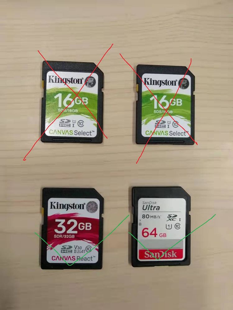

Hi everyone,
I had some trouble in deploying LS1028A BSP images using SD when following the steps in 'Layerscape LS1028A BSP User Guide (Supports BSP v0.3)'. I am afraid that there is something wrong with steps in the guide. I tried my best to figure out a right way. I had the same approach with the solution in Errors in Quick Start section of LS1028A BSP User Guide 0.3 by myself. But there is still the error of 'mmcblk0: error -84 transferring data, sector 2277376, nr 8, cmd response 0x900, card status 0xc00'. And the Ubuntu would go into emergency mode. No writing operation is permitted.
I checked almost all the posts on LS1028ARDB. I found that many guys had the same problem. I tried almost all the solutions provided in the posts. But no one works. I still get the error. So, is there an available solution for the deploying of the BSP? Or it is just an unfinished job? It took me almost one week. To be honest, I am disappointed with the guide and the support from NXP official.
Is there anyone who solved the error of 'mmcblk0: error -84 transferring data, sector 2277376, nr 8, cmd response 0x900, card status 0xc00' and run Ubuntu in a normal way?

Hi Jeremy and all,
Use a different SD card rather than the card shipped in the package. The shipped SD card will always has the error of 'mmcblk0: error -84 transferring data, sector 2277376, nr 8, cmd response 0x900, card status 0xc00'.
I try 2 other SD cards, both work. I am not sure if it is about size or model.
And I can't help complaining again to the guys who work for LS1028ARDB, could you please test your solution before selling it? We could deal with the user guide with errors, but how can we imagine every SD card come with the product is incompatible with it! I waste at least 3 days on it.Very bad impression on NXP now. :smileysad:

jeremy_impson
Can confirm. I used a SANDISK brand Class C10 micro SD card in a standard sized SD carrier, and it is working as well. Full Ubuntu userland, no I/O errors following read of every file on the image (find / -type f -exec cat {} \; > /dev/null).

Hello Yaolei. I'm having the same errors that you have. I've got a post here with no resolution as of this writing.
I was hoping they were caused by two bad SD cards, but the fact you are having these errors too suggests otherwise.. But maybe it's an incompatibility. I'm using the cards that came with the devices, which for me are Kingston 16 GB "Canvas Select" with a number 97269-E04.A00LF written on the back. What cards are you using?
