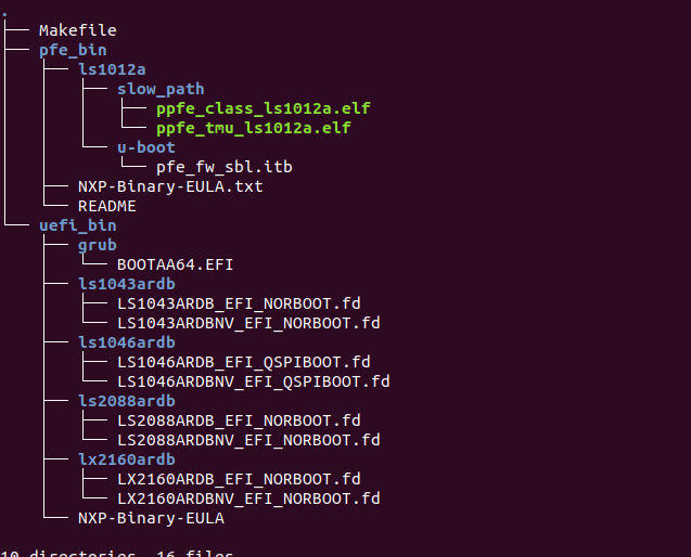

is the
flex-builder -i mkfw -m ls1021atwr -b sd
apply for eMMC too ?
Also again this is what I have under /flexbuild_lsdk1906/packages/firmware
I do not have anything called u-boot folder under this folder how to generate that folder here
