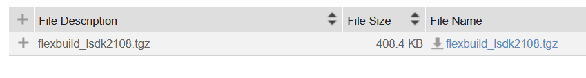

I am currently making mine firmware_ls1043ardb_sdboot.img file with this flex-builder version:
In this version I get U-boot 2021.04.
i want U-Boot version U-boot 2017.07-g503eff0.
