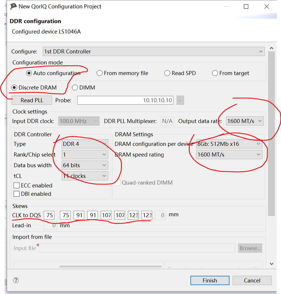

We defined CONFIG_STATIC_DDR, and try to figure out the struct ddr_cfg_regs from CodeWarrior DDR configuration tool.
When creating the project, we chose Auto configuration mode, Discrete DRAM, and slect 1600MT/s for test, the skews between CKL and DQS is got from PCB tool.
After enter Component Inspector page, we change the DQ mapping with Default,according with the schematic. The DQ pins didn't swap.
Keeping other parameters with the tools giving.

Hello 文炳 项,
For discrete DDR4 parameters configuration, first you need to create a QCVS DDR Memory Controller Configuration  project with default configuration parameters, then modify parameters in Properties panel according to your DDR datasheet to generate the initial DDR controller configuration parameters, then use DDRv tool to connect to the target board to do validation, optimization and operational DDR test.
Please refer to https://community.nxp.com/docs/DOC-333349
You could configure your target board as hard-coded RCW first, then do DDR validation with DDRv tool.

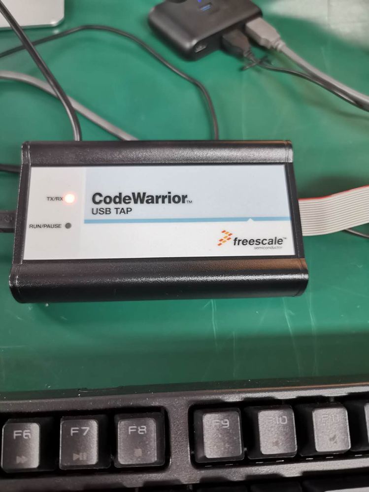

BTY, I have a tools: Codewarrior USB TAP, can it work for LS1046A?
I install CodeWarrior Development Studio for QorIQ LS series - ARM V8 ISA V11.4,but the Codewarrior USB TAP couldn't find the right driver.
Where can I download the right driver?

yipingwang
Hello 文炳 项,
In your screenshot, it seems that you are using CodeWarrior TAP (only integrates USB port), which only supports PowerPC target board.
Please purchase CodeWarrior TAP and probe tip for Layerscape from CodeWarrior® TAP | NXP .
Regarding USB TAP driver problem.
Please reinstall driver in Freescale\CW4NET_v2019.01_test\Common\CCS\drivers\usb.
If this problem remains, please try to use CodeWarrior TAP Ethernet connection.
Please refer to "Chapter 2  Connecting to Network" in the attached user manual to set up CodeWarrior TAP Ethernet connection.
