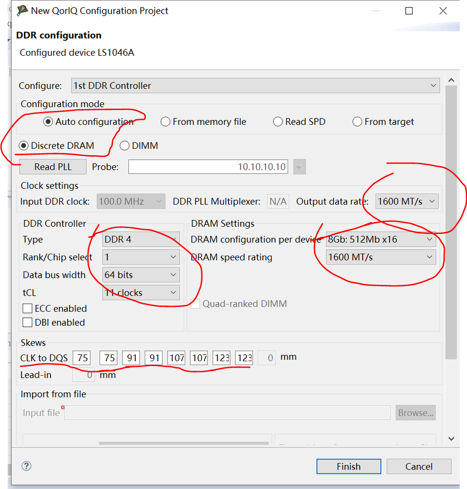

We designed a custom LS1046A board with 4GB DDR4,which use 4 NT5AD512M16A4-HRI(512MBx16).
The data bus is 64bits. And we use layerscape SDK 19.09, so we need modify the DDR initialization code in ATF component。
We defined CONFIG_STATIC_DDR, and try to figure out the struct ddr_cfg_regs from CodeWarrior DDR configuration tool.
When creating the project, we chose Auto configuration mode, Discrete DRAM, and slect 1600MT/s for test, the skews between CKL and DQS is got from PCB tool.
After enter Component Inspector page, we change the DQ mapping with Default,according with the schematic. The DQ pins didn't swap.
Keeping other parameters with the tools giving.

For discrete DDR4 parameters configuration, first you need to create a QCVS DDR Memory Controller Configuration  project with default configuration parameters, then modify parameters in Properties panel according to your DDR datasheet to generate the initial DDR controller configuration parameters, then use DDRv tool to connect to the target board to do validation, optimization and operational DDR test.
Please refer to https://community.nxp.com/docs/DOC-333349
You could configure your target board as hard-coded RCW first, then do DDR validation with DDRv tool.

My problem is I dosen't have Codewarrior TAP hardware tools. So i can't run DDRv tool to get the optimization parameters .
No I slow down the DDR rate to 1250MT/s,and use the register value from QCVS DDR Memory Controller Configuration. It can run to up kernel, but fail at init SD card.
So Yiping, could you have some suggestion about how to optimize the parameters without  Codewarrior TAP.

yipingwang
Hello 文炳 项,
In your screenshot, it seems that you are using CodeWarrior TAP (only integrates USB port), which only supports PowerPC target board.
Please purchase CodeWarrior TAP and probe tip for Layerscape from CodeWarrior® TAP | NXP .
