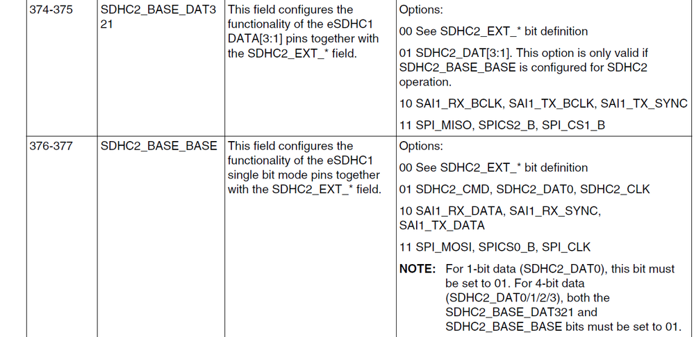

yipingwang
Hello Thomas Hoppe,
I checked FRDM-LS1012A  dts and Kernel configuration file, SPI is enabled by default.
I suspect you didn't configure RCW correctly to enable SPI, please refer to the following RCW definition from LS1012A Reference Manual, SPI pins are multiplexed with SDHC, so please configure these fields as "11" to support SPI.
Please use the command "sf probe" under u-boot to check whether SPI devices can be detected successfully.
If your problem remains, please provide your u-boot and Linux Kernel booting up log.
