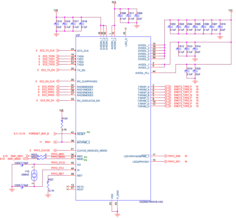

Our design needs to connect a switch chip with the rgmii interface of LS1043A. The MARVELL 88E6390 11 port GE Switch is connected to EC2 using RGMII. We don't know how to connect the RGMII signals.
Option A:
88E_INCLK---------------EC2_GTX_CLK
88E_IND[3:0]-------------EC2_TXD[3:0]
88E_INDV-----------------EC2_TX_EN
88E_OUTCLK------------EC2_RX_CLK
88E_OUTD[3:0]----------EC2_RXD[3:0]
88E_OUTEN--------------EC2_RX_DV
Option B:
88E_INCLK---------------EC2_RX_CLK
88E_IND[3:0]-------------EC2_RXD[3:0]
88E_INDV-----------------EC2_RX_DV
88E_OUTCLK------------EC2_GTX_CLK
88E_OUTD[3:0]----------EC2_TXD[3:0]
88E_OUTEN--------------EC2_TX_EN
Which option is correct and why?

From the provided data sheet:
88E6390 Signal
RGMII function
P0_INCLK
RXC
P0_INDV
RX_CTL
P0_IND[3:0]
RXD[3:0]
P0_OUTCLK
TXC
P0_OUTEN
TX_CTL
P0_OUTD[3:0]
TXD[3:0]
So option A is correct.
3,343 Views
danielzdh
Thank you for your reply, but according to the reference design(MPC-LS Vehicle Network Processing reference design), the connection between ls1043a and ksz9031 uses the scheme of Option B.
Therefore, when Option A should be adopted and when Option B should be adopted?
