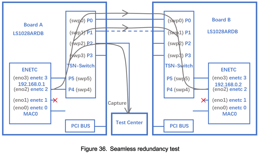

I check the 8.1.4.7 about redundancy test. The test diagram indeed shows the test center to capture traffic from swp2. Do you mean the swp2 is mirroring the "cbstreams" in the test case?
It seems the duplicate frames for 802.1CB purpose and it needs to configure "cbstreams" at first. My original intention is to monitor any traffics (not limited to TSN cbstreams) on the mirror port.

yipingwang
