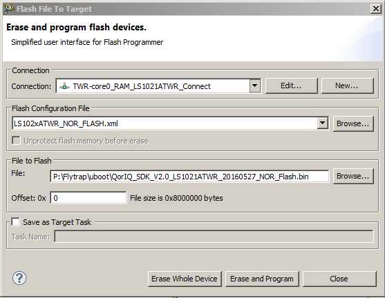

I accidently erased bank 0.
Using CW (attached snapshot) I tried to reprogram the flash with the file:
QorIQ_SDK_V2.0_LS1021ATWR_20160527_NOR_Flash.bin
I clicked: "Erase Whole Device" and then "Erase and program".
After few seconds I got:
Error: Connect failed. No sectors selected
Unknown protocol error (CCSProtocolPlugin)
Error: Connect failed. No sectors selected.
Can you help ?
Thank you,
Z.V

Please confirm whether the board is capable to boot from QSPI.
What is the TWR revision (PA or PB)?
6,349 Views
z_v
The revision is PB.
How can I boot from QSPI ?
Thank you,
Z.V
6,349 Views
ufedor
Please refer to the TWR-LS1021A Getting Started, Table 2. Default switch settings.
Set SW2[1:8]=0b'0001'0111 (0 - OFF).

z_v
I tried programming. Following are my settings:
Then I clicked 'Erase and Program' and got the following messages:
fl::target -lc "LC for Simple Flash"
fl::target -b 0x10000000 0x20000
fl::target -v off -l off
cmdwin::fl::device -d "JS28F00AM29EWHA" -o "64Mx16x1" -a 0x60000000 0x67ffffff
cmdwin::fl::image -f "P:\\Flytrap\\uboot\\QorIQ_SDK_V2.0_LS1021ATWR_20160527_NOR_Flash.bin" -t "Auto Detect" -re on -r 0x60000000 0x67ffffff -oe off
cmdwin::fl::erase image
 Beginning Operation ...
Auto-detection is successful.
  File is of type Binary/Raw Format.
Image size is 0 bytes, nothing to erase.
Nothing to erase.  No sectors selected
Performing target initialization ...
     1570200  <m>0x00000000</m>   ....
Erase Command Succeeded.
cmdwin::fl::write
Using restricted address range 0x60000000 to 0x67FFFFFF
Programming file P:\Flytrap\uboot\QorIQ_SDK_V2.0_LS1021ATWR_20160527_NOR_Flash.bin
 0 Bytes Programmed, Check Restricted Address Range
Program Command Succeeded
It seems the erase phase is OK.
What is the reason for the "Check Restricted Address Range" ?
Z.V
6,349 Views
ufedor
Please refer to the SDK Documentation:
Submit Form
Consider that in the described case only one binary image (128MB) has to be programmed.
It is not absolutely required check the "Restrict to Address in this Range", but required to check "Apply Address Offset" with value 0x60000000.
6,349 Views
