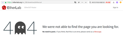

I got an error when I try to bitbake nxp-image-real-time-edge v2.6 for ls1028 board;
for the url I try it on my browser and it pops 404 error like down below:
http://etherlab.org/download/ethercat/
it doesn't have this page?

  The tarball that you need can be found at:
www.nxp.com/lgfiles/updates/other/ethercat-1.5.2.tar.bz2

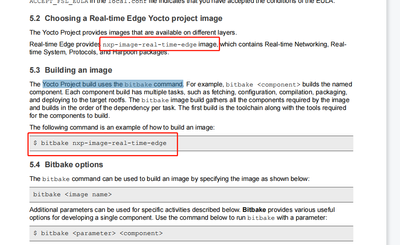

5,698 Views
xinliwang
Hi, @Irene
I don't get it what do you mean that you dont find nxp-image-real-time-edge”?
According to the reference menu RTEDGEYOCTOUG_Rev2.6 on page 8, Yocto Project build uses the bitbake command.
