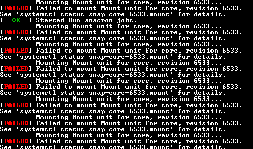

Hi all,
I deployed the LSDK19.09 by flex-installer successfully. But after I start the system from SD card boot, it continuously report errors as below:
[FAILED] Failed to mount Mount unit for core, revision 6533.
See 'systemctl status snap-core-6533.mount' for details.
Do you have any idea?
   Yi

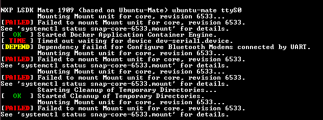

The starting log is attached for your information. I did not find special difference from yours. Do you know what is the "Mounting Mount unit for core, revision 6533..."?
NXP LSDK Mate 1909 (based on Ubuntu-Mate) ubuntu-mate ttyS0
ubuntu-mate login: root
Welcome to Ubuntu 18.04.2 LTS (GNU/Linux 4.19.68 aarch64)
 * Documentation:  https://help.ubuntu.com
 * Management:     https://landscape.canonical.com
 * Support:        https://ubuntu.com/advantage
372 packages can be updated.
214 updates are security updates.
The programs included with the Ubuntu system are free software;
the exact distribution terms for each program are described in the
individual files in /usr/share/doc/*/copyright.
Ubuntu comes with ABSOLUTELY NO WARRANTY, to the extent permitted by
applicable law.
[ TIME ] Timed out waiting for device dev-serial1.device.
[DEPEND] Dependency failed for Configure Bluetooth Modems connected by UART.
         Starting Message of the Day...
[  OK  ] Started Message of the Day.

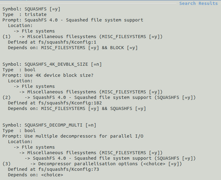

It seems that Kernel doesn't support squashfs, which is a requirement for snaps.
2,079 Views

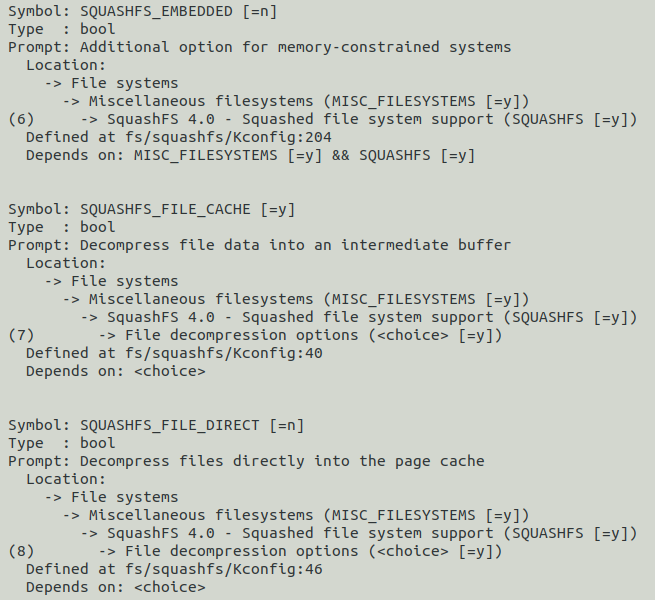

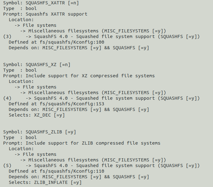

yyu2
Hi Yiping,
I checked my linux config by "flex-builder -c linux:custom" and it showed "SQUASHFS [= y]" etc.
Could you help to check the your configurations to identify the difference from mine?
   Yi
