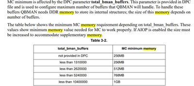

priyadharshinik
Thanks for your response.
Yes, I can reduce mcmemsize environmental variable to “0x40000000” (1GB).
But as mentioned, we are using only one management port in our current design.
So we still want to reduce the mcmemsize to “0x8000000” (128MB) and use the rest of the memory for application.
But when we reduce the mcmemsize to 0x8000000 (128MB), we are getting below error in u-boot while loading MC firmware.
fsl-mc: Booting Management Complex ... WARNING: Firmware returned an error (GSR: 0xd)
fsl-mc: Management Complex booted (version: 10.20.4, boot status: 0xd)
Here is the reference from DPAA2 user manual. As per the below given table, we would want to disable  QBMAN and AIOP and check if mcmemsize of 128MB works and MC firmware gets loaded properly in uboot.
So, Please help on how to reduce mcmemsize to 128MB .

priyadharshinik
Thanks for the response.
I have set mcmemsize to 128MB  and mcmemsize environment variable is updated.
But still, 512MB is reserved, when i checked "bdinfo" in uboot.
Is it because of SYS_MC_RSV_MEM_ALIGN set to default 0x2000000 (512MB) in drivers/net/fsl-mc/Kconfig?
If I change that to 128MB, would 128MB memory be reserved?
Do you advice to change the above config and reserve 128MB for MC or minimum 512MB needs to be reserved?
In DPAA2 Manual, minimum memory requirement is “128MB” for LS2044A based architectures..
So, we would like to reduce the reserved memory to 128MB and use rest of the RAM for application.
And we want to make sure, we are able to connect to multiple ssh connections and ethernet management interface works fine with 128MB reserved.
Please suggest…

yipingwang
You could configure SYS_MC_RSV_MEM_ALIGN in drivers/net/fsl-mc/Kconfig to 128M.
