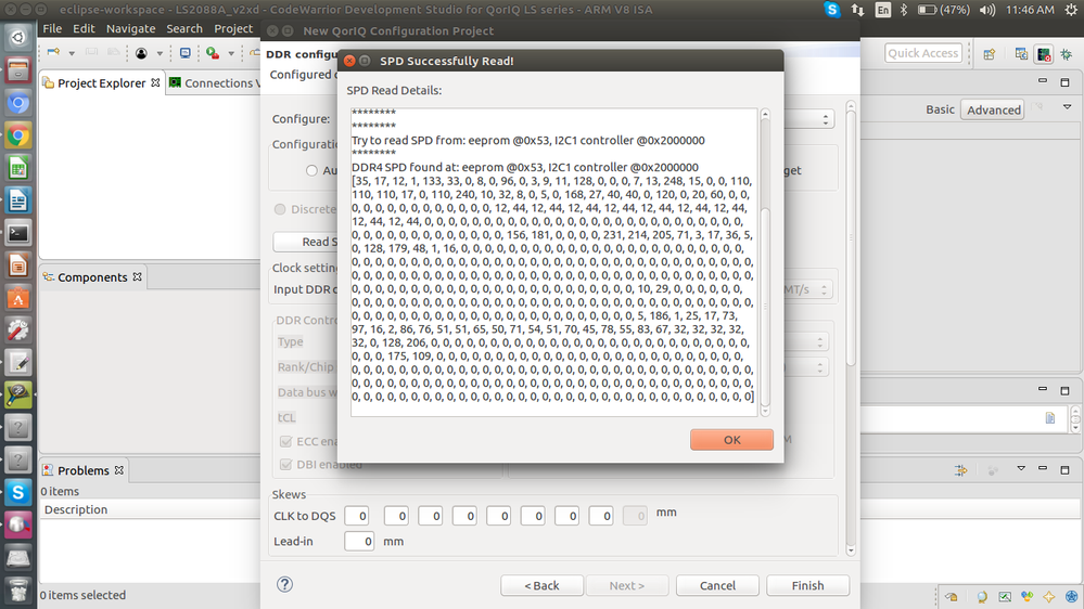

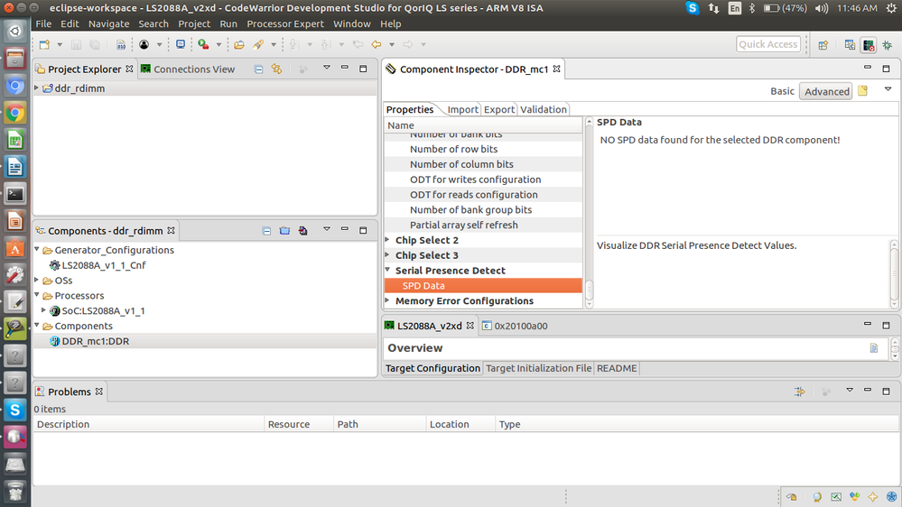

Hi Yiping,
We are able to read SPD but we are not able apply SPD data in QCVS project attaching referenceddr_rdimm_1.pngddr_rdimm_spd_1.png

Hello pradeep TG,
When create a QCVS DDR project, please select the configuration mode as "Read SPD" in DDR configuration panel, after click "Read SPD" to connect to the target board to read SPD from the target board successfully, please follow the new project  wizards to continue to create QCVS project. Then the initial DDR controller configuration parameters will be generated according to values reading from SPD.
