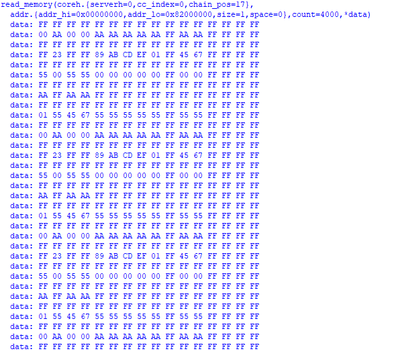

Hi all,
I am in the process of trying to bring up a LS1046A board. Its a custom board based heavily off the Freeway design. The first step I am trying to do is get the connection diagnostics to pass with RCW override and DDR settings. D_INIT is cleared and its gets to the DDR memory access test. However when checking logs I can see that the DDR values do not match their expected values. See picture and logs(Read_Write_mem.txt). I see some resemblance of the expected values. D_Init_value is set to 0xDEADBEEF.

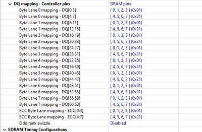

- DQS skews are correct and double checked with schematics
- DQ mapping should be correct. Using the exact same layout as the Freeway board. See attached.
I am unable to find a DDR config for the Freeway board. Is this something we can get to compare to our settings? Any pointers to what might be wrong? Im assuming its settings related since D_INIT is cleared and we are actually able to read/write to DDR.
You can also find the logs below for the test for centering the clocks. Its ran with RCW override with the RCW mentioned below. CCS Output is also added.

yipingwang
DDRv tool doesn't use the DDR parameters coming from the firmware deployed on the target board. Please ignore atf software.
When starting the validation, DDRv tool will reset the target board and configure the target board according to the parameters filed in DDRv tool properties panel.
So you need to modify "properties" panel according to your DDR datasheet.
If your problem persists, would you please capture CCS console and error log in QCVS DDRv tool IDE?
