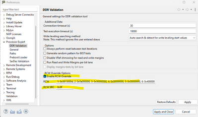

1. If DDRv tool does not support RCW overriding. What it this setting for?
Thanks for the find in the RCW. Found it aswell and changed it to 2100. Does not make a difference.
You point to ARMv8_Targeting_Manual.pdf section 8.6 for bringup of the board. This requires the flash manager to work. Flash manager requires the initialization file which requires DDR to function. So I first need to create a working DDR config before I can flash RCW right?
10,294 Views
yipingwang
The flash programmer is configured to use OCRAM(rather than DDR) in CodeWarrior, you could use CodeWarrior to program RCW to QSPI flash first.

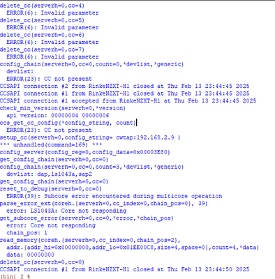

Im also trying to run the initialization file without RCW override now. It was telling me to remove the RESET_REQ_B signal line from the reset cirquit to get a better error. After disconnecting I get this message. When I dump the contents of the QSPI memory I can see the contents of the RCW and preamble are all in the QSPI. Also when checking QSPI clock we can see a nice signal on boot being there. How do we solve this?
10,229 Views
yipingwang
For QSPI flash RCW, byte swap is required. However in the recent released SDK byte swap script is provide in ATF source code.  Please refer to the following procedure to generate ATF pbl image.
$ git clone https://github.com/nxp-qoriq/atf.git
$ cd atf
$ git checkout -b LSDK-21.08 LSDK-21.08
$ sudo apt-get install gcc-aarch64-linux-gnu
$ export CROSS_COMPILE=aarch64-linux-gnu-
$ make PLAT=ls1046afrwy bl2 BOOT_MODE=qspi pbl RCW=~/data/rcw/ls1046afrwy/NN_NNQNNPNP_3040_0506/test.bin
Note: please specify RCW binary path generated by you.
You will get build/ls1046afrwy/release/bl2_qspi.pbl, please program bl2_qspi.pbl at offset 0 of QSPI flash.
Please refer to the attached image generate with your RCW text file.

    debug = ddr_init.read_debug_regs(ddr_ctrl, session)
  File "C:\Freescale\CW4NET_v2020.06\Common\QCVS\Optimization\resources\QorIQ\ARMv8\ddr\ddr_init.py", line 812, in read_debug_regs
    swap = (ddr_ctrl['endianness'][default_space] == 'little_endian')
KeyError: 'endianness'

Rinke
When I use your exact RCW values I am getting this:
I emptied the QSPI memory before to make sure nothing is interfering.
Your RCW itself does not work for me. Once I change RCW5 to 0x00f00002. So powering down the Serdes and uncommenting 6 (For selecting QSPI boot) it will work for me.
        TA.rcw.set_data({1: 0x0C150010})
        TA.rcw.set_data({2: 0x0e000000})
        TA.rcw.set_data({3: 0x00000000})
        TA.rcw.set_data({4: 0x00000000})
        TA.rcw.set_data({5: 0x00000000})
        TA.rcw.set_data({6: 0x00f00002})
        #TA.rcw.set_data({7: 0x40000000})
        TA.rcw.set_data({8: 0xc1000000})
        TA.rcw.set_data({9: 0x00000000})
        TA.rcw.set_data({10: 0x00000000})
        TA.rcw.set_data({11: 0x00000000})
        # Configure UART
        TA.rcw.set_data({12: 0x00000800})
        # Configure QSPI
        TA.rcw.set_data({13: 0x00000000})
        TA.rcw.set_data({14: 0x00000000})
        TA.rcw.set_data({15: 0x00000096})
        TA.rcw.set_data({16: 0x00000001})
9,631 Views

  1. When creating a QCVS DDR project, in DDR configuration panel, please select configuration mode as "From memory file" and "Discrete DRAM" and specify the input file as the attached CodeWarrior Register Text file.
  1. Please double click "DDR_mc1:DDR" to open Properties panel, please modify parameters in Properties panel according to your DDR datasheet and the schematics of your target board.
      Then save the configurations to do DDR validation.
