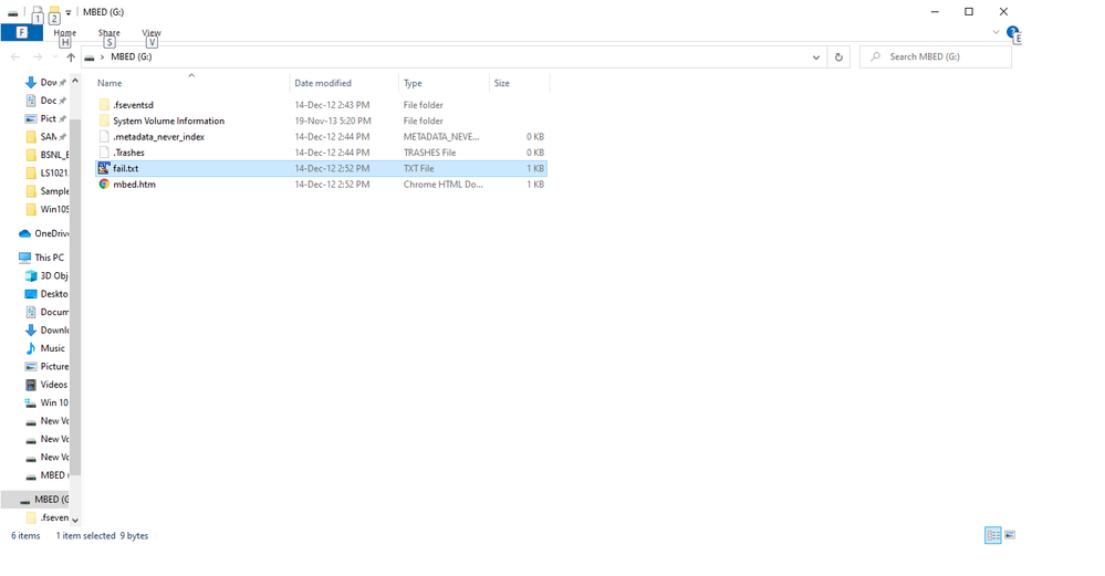

I'm working on a LS1021ATSN-PA development board. I'm facing an issue with its console port access from my Windows 10 PC. As mentioned in the quick start guide, I've connected the board's Micro USB console port to my PC using the Micro-B USB cable. The cable connection detected at the PC and appeared as a USB Mass Storage Device under the USB controllers of the Device Manager. But it does not appear as a COM port. I found a note from the MBED saying that Windows 10 does not require a specific serial driver to enable the COM port, however an older version of Windows 8 or lesser requires it. In my Windows 10 PC I cannot find the virtual COM port corresponding to this USB connection.
How do I resolve the issue? Kindly help me to proceed on it.

Abhilash_PV
I've followed the same steps mentioned along with the Windows 10 workaround procedure. But it did not solve my issue.
After copying CMSIS-DAP firmware image "k22fx512_if_mbed.bin" into the "BOOTLOADER" named drive, the 'K22' marked status LED on the board blinks very fast. Then on unplugging and re-plugging of USB cable caused a drive named "MBED" appears on my PC. No virtual COM port is being created corresponding to the console port. I have re-enabled "Storage Services" in my PC and checked again. No difference observed (Only "MBED" drive appeared and no virtual COM port).
MBED DriveMBED Drive
I have noticed a file named "fail.txt" in the "MBED" drive path as shown above. Content inside the text file is "SWD ERROR".
Am I right in the procedure that I followed? Is there any other image I've to use further to the above procedure?

yipingwang
Please try the attached firmware image.
After plug in USB cable, please wait for while until the system is stable.
3,084 Views

reginaldstjohn
We are seeing the same issue. Installed the k22fx512_if_mbed.bin, turned off the service "Storage Service" (There is no Storage Services),
Still no com port showing up in Windows 10 as of Oct-2021
