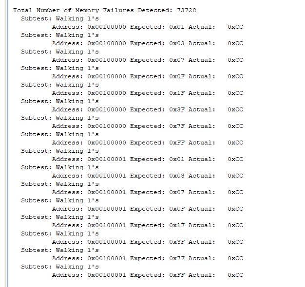

I recently performed a memory test for the hardware eMMC of my ls1021a as well as LS1021a-TWR SD card.
Anyone knows what's going on here ? It kept failing I did not know why it's expecting some values for example 0X7F but instead 0XCC, I thought it suppose to be initialize all values to 0s first then perform the test but seems like it's not the case.

Memory tests are intended to be used with RAM-type memories (volatile memories), where the number or read/write operations is not limited, and memory interface is parallel (for higher bandwidth). Every memory test type is effective against it particular defect type. For example, "Walking ones" test. In this test you write all memory with 00000001 and than read back to check, and rotate this pattern in cycle. This memory test is used to test data bus line, assuming your data bus connection to memory is parallel bus.
In eMMC case, there is no parallel data bus, so - no need to test it with walking ones. Also, eMMC memory is flash-type memory, it has limited number of writes, as any other flash. Continious write and read the same memory cell may damage this memory. So, testing flash-type memory with standart memory tests is not recommended.

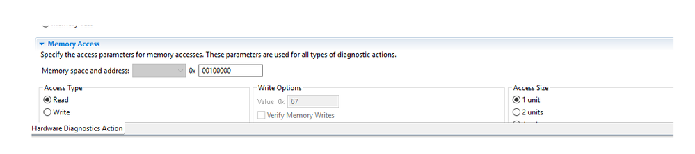

how could I test my RAM if the only way I can establish the communication between my board and Codewarrior is via the OCRAM?
Also by saying testing the RAM you mean I change the value here
to 0x80000000?  since 80000000 is the RAM

Before running memory test, the memory must be enabled and initialized in memory controller registers. As a part of this initialization, memory base address and size is configured. If the board is running under CodeWarrior control, this is performed in target initialization file. Common RAM (DDR memory) usually starts at 0x00000000, however this starting address is configurable in target initialization file. So, please refer to your CodeWarrior target initialization file for memory starting address.

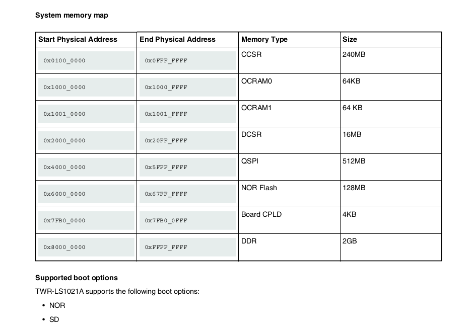

But the LSDK1906 says 0x8000_0000
8,651 Views
alexander_yakov
Yes, specifically for LS1021A processor DRAM starts at 0x80000000 (region 1, 2GB size). Starting address 0x00000000 is used for Secure boot ROM. The same is said in LS1021A Reference Manual, Table 2-1 "System memory map"

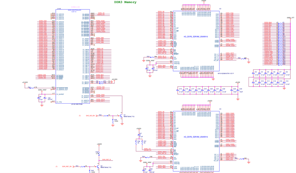

I have 2 4GB DDR3 connected instead of only one as EVA board does. i don't think they are the same as EVA?
(2) I have the access into the my board now from serial console but it shows 1 GB of DDR in the uboot but I have 4 GB DDR what is the issue here, also when I perform free -m in the linux I saw only 1GB DDR available as well.
8,651 Views
alexander_yakov
1. Yes, if you have two memory chips instead of one used on our development board, than this means target initialization file for our development board is not directly applicable for your custom board, and some changes in memory settings are required.
2. U-boot uses its own settings, it does not use CodeWarrior target initialization file. So, U-boot memory configuration settings should be also updated to accomodate new memory configuration.
