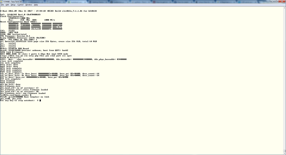

When I'm starting the LS1012ARDB board and the U-Boot message prompts me to hit any key to stop autoboot, I tried hitting keys but the terminal did not respond. I tried multiple cables so I don't think cable connection is the problem.
What might be causing this issue?

Is there problem for console using on your board if Linux is loaded and started?

It looks like that there is a problem of your terminal setting.
Check your terminal setting using the following pages:
http://www.armadeus.org/wiki/index.php?title=Connection_with_U-Boot_under_Windows
or
https://www.denx.de/wiki/DULG/SystemSetup
or
https://boundarydevices.com/just-getting-started/
Look at also attached file. Find the CONFIG_BOOTDELAY in this file. Perhaps the CONFIG_BOOTDELAY is set to 0 in your u-boot.

Hi Pavel,
I've checked and the terminal settings are correct. Also the CONFIG_BOOTDELAY value started from 10 so that's not the issue either.
I've taken a screenshot of the U-Boot message, perhaps that might be more telling of the issue that I have.
