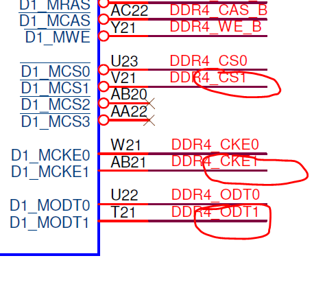

Hello NXP,
I'd like to ask if AS4C512M8D4A-75BCN is a compatible alternative part for MT40A512MB to be used on LS1043A board.
Specifically, because the AS4C512M8D4A-75BCN chip doesn't use the CS1, CKE1, and ODT1 pins.

We do not have a list of memory, all JEDEC compliant devices are ok.
