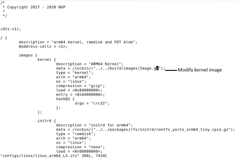

This topic shows steps to customize LITB by using a different kernel image instead of the existing kernel image.
  1. Browse to the FlexBuild installation directory.
  2. Modify the kernel image in linux_arm64_LS.its.
    $ vi configs/linux/linux_arm64_LS.its
  3. Save the changes done in the file.
