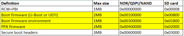

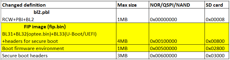

The following figures highlight the changes in the flash layout for boot flow with PPA and flash layout for new TF-A boot flow.
Flash layout for boot flow with PPA
Changed flash layout for TF-A boot flow
