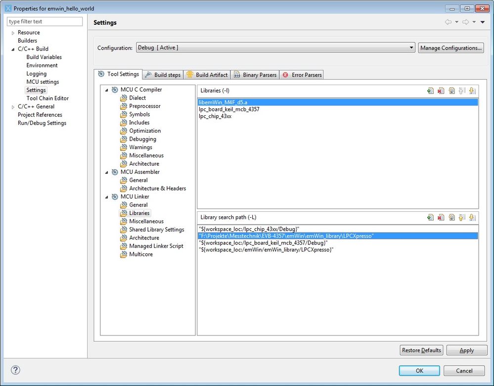

I have downloaded the EmWin-library according the installation.txt in emwin directory. Now I have in this directory all library files in the subdirectory emWin_library\LPCXpresso. In my project "emwin_hello_world" I have integrated the search path.
But I still get an error, that the library is not found.
Can anybody help me in this subject?
With best regards
Andreas Kneissl

remove 'lib' from the start and '.a' from the end of the library name. The GNU linker automatically adds these. i.e. just use emWin_M4F
