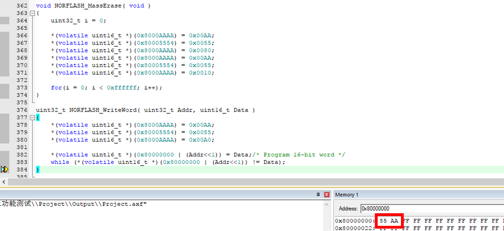

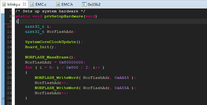

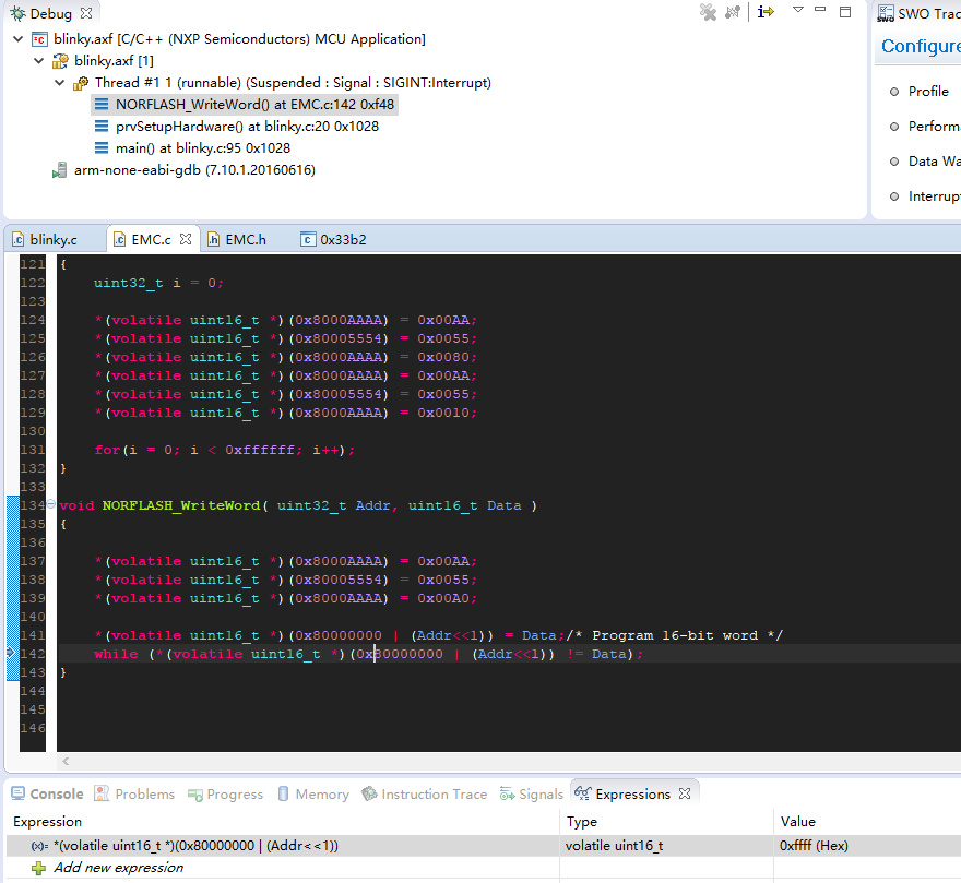

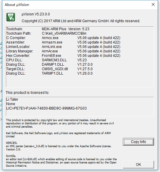

I want to test the following code.
It will be fail.hang on this line.
but if this code run in keil,it will be ok.
all the code are same.Including clock configuration, no other peripheral functions.and compare all the register are same.
Keil Version.
LPCXpresso IDE Version.
Debugger.
What can i do for next.

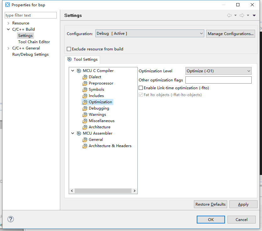

Very good, I found where the BUG.
Complier!!!!!!!!!
-O3 at LPCXpresso are fail,-O2,-Os at LPCXpresso are partial failure,-O1,-O0,-Og can be ok.
The debug level does not affect the results.
but at keil,all Optimization level are ok.

This probably is not a tools issues as such.As I said previously, check the initialisation code that sets up the memory interface. I assume there is some difference between this code in your LPCXpresso and Keil projects.

at this line,LPCXpresso always read out 0xFFFF,but i don't know what the happen.
 while (*(volatile uint16_t *)(0x80000000 | (Addr<<1)) != Data);
but the same code in keil works well.
