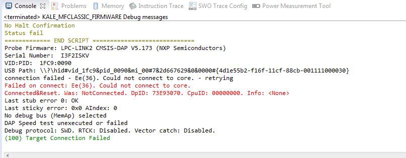

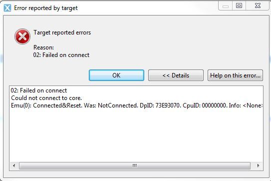

I try to load program LPC1227 wit use LPC-Link2 . I followed the instructions, but I got an connection error. LPCXpresso IDE can see LPC-Link2 but LPC-Link2 can not see LPC1227 MCU. So I took Connection failed to MCU error.
Extra Info: When I try to connect the LPC1227, Against the possibility of making mistakes I try all JP1 and JP2 position combinations. But it is not working...
* I successfully installed LPC-Link2.
* LPCXpresso IDE see LPC-Link2

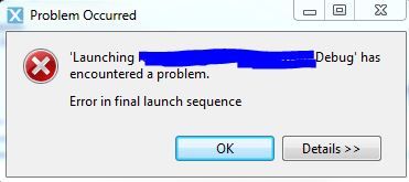

*Got error failed on connect
* Debug error due to connection failure
Possible error possibilities:
* My Debug configurations may be incorrect. When I checked the boot debug probe, I noticed that the probe was LinkServer. Is it correct?
*I am absolutely sure that the MCU is working because I have already programmed it via LPCXpresso with Jlink Segger.
But now I want to upload program with use LPC-Link2. I initially connect the ISP pin to GND. Then I take it back to switch debug mode the LPC1227. Maybe I'm making a mistake at this point.
Do you have any idea about the connection failure?

Yes, for use with LPC-Link2, "LinkServer" is correct.
Try booting the part into ISP mode...
https://community.nxp.com/message/630748
And if this is your own board, check the requirements detailed at:
Design Considerations for Debug
and in particular make sure you have ISP pulled correctly.
The other thing to watch with LPC12 parts is the watchdog : LPC12 Watchdog
