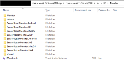

Hi Stevekuh,
Source code of the SensorBoardMonitor app is in:
Kind regards,

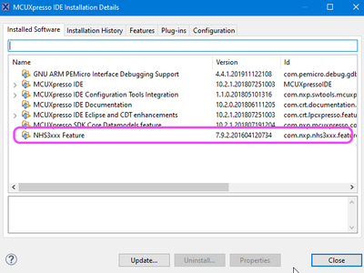

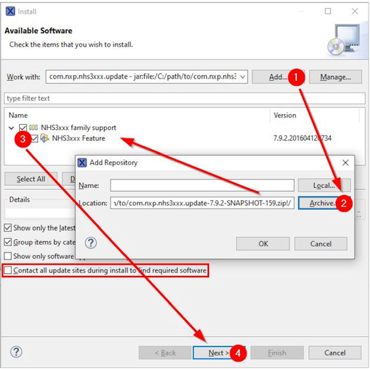

stevekuh
Could you send instructions on how to install the plugin?
17,782件の閲覧回数
danielchen
Hi @stevekuh
Please refer to below picture.
17,765件の閲覧回数
stevekuh

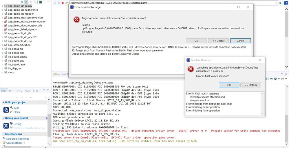

Successfully installed NHS3100. Compiled good with NHS3100 selected as MCU. Upon programming the error msg shown as attached.
17,754件の閲覧回数
danielchen
HI,
The error is "can not connect to core", I would suggest you check the debug probe you are using, update the firmware in it.   or try another debug probe
17,751件の閲覧回数

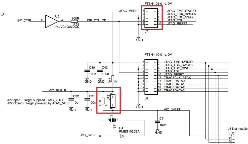

stevekuh
- Installed LPC Link2 USB driver package (Rev 2.0.2 May 11 2014)
==> didn't help
- closed JP2 on LPC Link2 PCB (apparently supplies 3.3v power to the target)
- produced different error msg as attached
17,737件の閲覧回数
stevekuh
I am using LPC-Link2 to program the NHS3100SENSORADK.
After closing the JP2 jumper on the LPC-Link2 PCB, I now have a different error message as shown above. How do I resolve this issue?
タグ(1)
17,726件の閲覧回数
danielchen

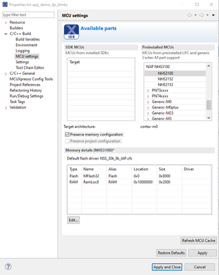

I would suggest you check the memory details in your project.
For example, the app_demo_dp_blinky ,
Please refer to UM11153 (NHS31XX getting started ) for more details.
17,721件の閲覧回数
stevekuh
- after fixing the memory and setting the flash driver to NSS_30k_8k_IAP.cfx, the blinky example compiled and flashed with no error.
- had to modify the led pin to PIO_8 (we are using NHS3100SENSORADK) since the default LED was set for Pin 7.
- now, I would like to compile and flash the default demo program that NHS3100SENSORADK shipped with and interfaced with an Android App (SensorBoard Monitor). Could you send us the demo code for this?

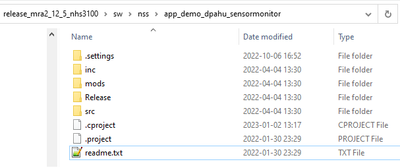

patrickgeens
NXP Apps Support
NXP Apps Support
Hi Stevekuh,
The source code for the SensorBoard firmware is in the NHS3100 SDK that can be downloaded at:
https://www.nxp.com/webapp/Download?colCode=release_mra2_nhs3100&appType=license
The "release_mra2_12_5_nhs3100\sw\nss\app_demo_dpahu_sensormonitor" project is the one you need.
Kind regards,
Patrick

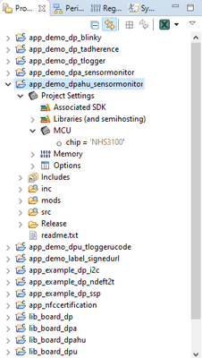

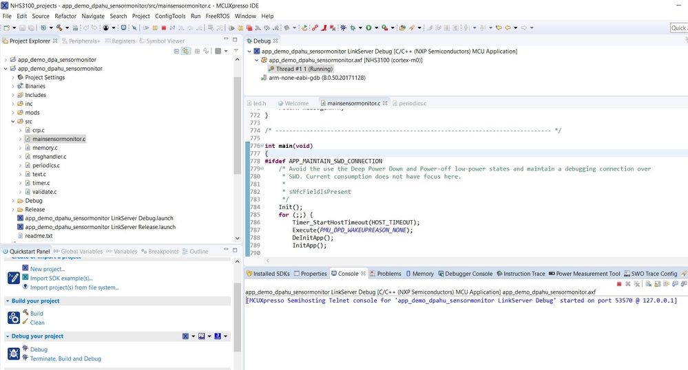

stevekuh
- compiled app_demo_dpahu_sensormonitor
- error generated as below:
- the issue is that the compiler is unable to find part support for NXP NHS3100 in project app_demo_dpahu_sensormonitor. It reset to a generic part. But, the project MCU Setting is set to NHS3100 with proper memory config.
タグ(2)

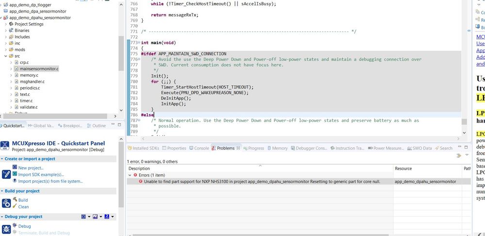

17,627件の閲覧回数
stevekuh
Actually, I am not sure if the Error msg is accurate. I flashed the ADK and received the following:

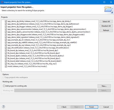

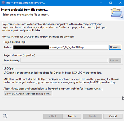

patrickgeens
NXP Apps Support
NXP Apps Support
Hi stevekuh,
I assume MCUXpresso 10.2.1 is used and the NHS31xx plugin is installed:
To check if your IDE is working correctly I propose the following test:
- create a new empty folder on disk
- start MCUXpresso 10.2.1 (or select File -> Switch Workspace if already running) and select the empty directory created above to become the new workspace. A blank workspace is shown.
- in the Quickstart panel: select Import project(s) from filesystem and select the SDK release zip file as downloaded from the NXP website:
Press Next>, press Finish: all projects are unzipped in the workspace directory and added in the IDE workspace panel
After the IDE has finished importing the projects, check the sensormonitor project MCU setting to see if it shows the NHS3100 setting
Build (and debug) the project to see if everything is working as expected. There should not be an error (actually more a warning) that a generic M0+ is selected.
Note: due to the code size the "release" build configuration is preferred, otherwise there is little flash left for storage. You will probably need to manually set the "release" build config on the "lib_board_dpahu" and "lib_chip_nss" projects, as the IDE not always propagates the setting automatically to the referenced projects. (if not done, there is a linker error stating "lib_chip_nss" and "lib_board_dpahu" is missing)

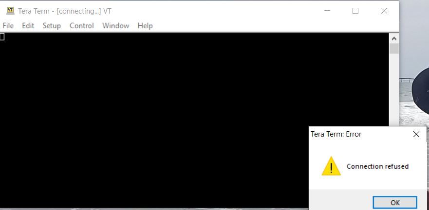

- upon following the instructions to start a new folder and brining the demo projects fresh, they all compile and debug correctly without errors.
- on Telnet, my setting doesn't work as shown:
Capture Tera Term Setting.JPGCapture Tera Term Err.JPGMCUXpresso Console.JPG
