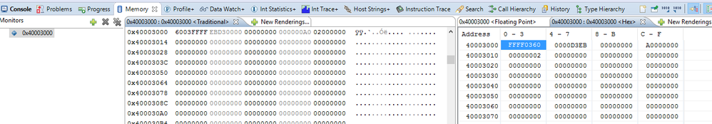

Now, when the breakpoint hits, in 7.4 we see this in memory.  This is pointing the the SPIFI registers:

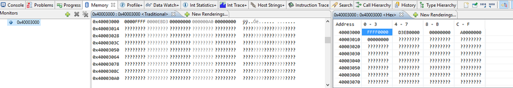

On the other hand, when running the IDENTICAL code under 8.2.2, we get the following memory report in the SPIFI registers:
Notice that in 7.4 the MSB of the SPIFI config register (at 0x40003000) are different that the same bits in 8.2.2.  Also note the byte order difference in the second word, presumably the CMD register.
Both samples use the same code with the same LPC library definition of LPC_SPIFI_T.  When running in 7.4, the application runs as expected.  In 8.2.2 we crash immediately when the next XIP code in flash attempts to execute, because the SPIFI has not changed to memory mode.
