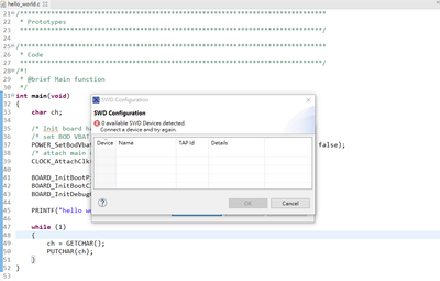

I have both LPC55s1x-EVK and LPC55s2x-EVK. They were working fine. I was able to debug with MCUXpresso IDE (v11.5.0). And suddenly I can't. MCUXpressor gave me an error saying that no device was found while my board was connected to the PC like when it was working fine.
I checked the device manager and it shows that LPC-LINK2 is still connected can be found by the MCUXpresso as shown below.
I tried to reset with ISP button and it didn't work. No hardware changes were done.
Thanks.

Please power cycle the boards and when you get the MCU into ISP mode perform a mass erase using the MCUXpresso or  try to do that mass erase using the  Flash Magic Tool  , this communicates with ROM bootloader.
If you are encounter more problems, or do not know how to do the recommended steps let me know.
