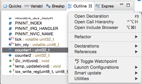

As mentioned previously, the method for setting Watchpoints is rather more hidden within the IDE than some other debugging features. One of the easiest ways to set a Watchpoint is to use the Outline View. By default this will be located within the LPCXpresso IDE Quickstart pane.
From this view you can locate global and static variables then simply select Toggle Watchpoints (or place Breakpoints on functions). Once set, they will appear within the Breakpoint pane alongside any breakpoints that have been set.

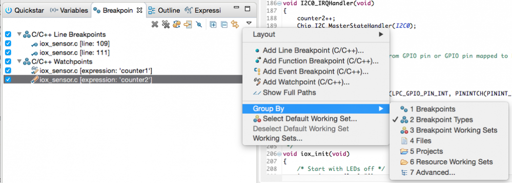

Note: To easily distinguish between Breakpoints and Watchpoints you can choose to group entries by Breakpoint type. From within the Breakpoints view, click the Eclipse Down Arrow Icon Menu, then you can select to Group By Breakpoint Types as shown below:
As you can see from the above graphic, the option to set a Watchpoint is also available from the Breakpoint view. When set from here, you will be offered an unpopulated dialogue - simply entering an address will cause a watchpoint to be created monitoring accesses to that address.

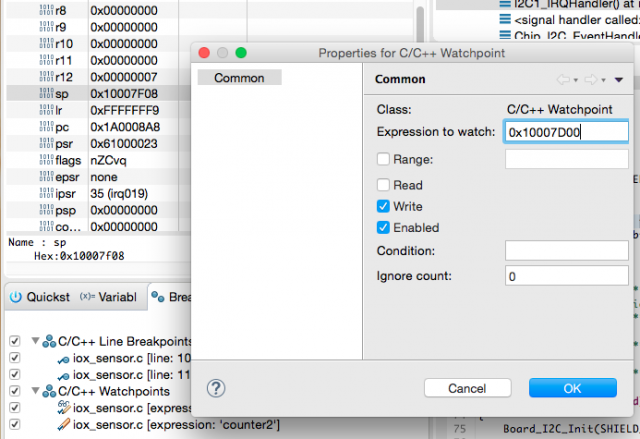

Using Watchpoints to monitor stack depth
Stacks on ARM based processors use a Full Descending scheme and so have the potential to descend into areas of memory used for other purposes (typically holding global data). Establishing the maximum depth of an applications stack can be a challenge especially since any memory corruption due to excessive stack use may not be immediately apparent.  Watchpoints may be used to monitor a fixed depth during program execution to explore the stack depth being reached and then review the area of code that caused the occurrence.
Below an address has been selected to watch for the Stack reaching 0x10007D00.
Watchpoints are a very simply way of monitoring stack depth when an application is running.
Watchpoints can be configured to halt on a Read (or Load), Write (or Store), or both. Since watchpoints 'watch' accesses to memory, they are suitable for tracking accesses to global or static variables, and any data accesses to memory including those to memory mapped peripherals.
