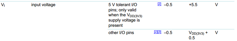

what this line of datasheet means?
1,907 Views
navidansari
hi
it says other pins have limitation of VDD+.5
what pins are other pins?
im using usart1 of lpc1768
can p2.1 recieve 5V signal and not break?

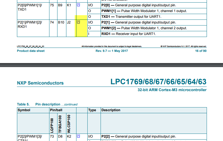

in what page of datasheet says it can or it can not?
1,783 Views
soledad

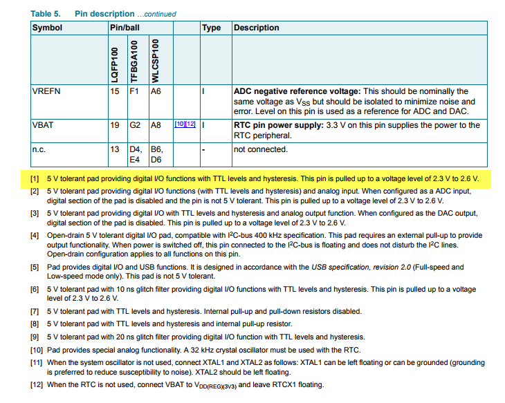

Please check the table 5(pin description) from the datasheet below:
http://www.nxp.com/docs/en/data-sheet/LPC1769_68_67_66_65_64_63.pdf
In this table you can find a note about if this pin is 5v tolerant.

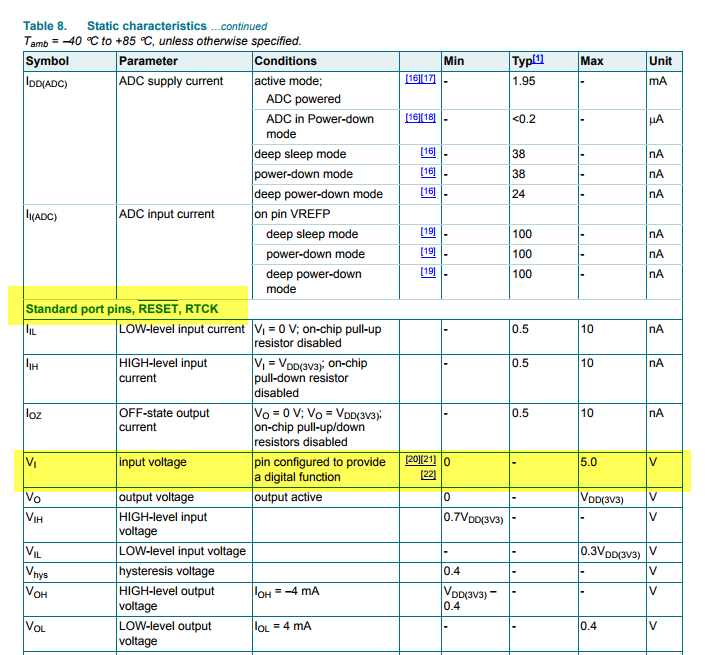

In addition please check the table 8. (static characteristics)
