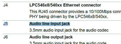

hi, i am suraj,
why j5 connector has to be connected while dumping the code to the board via the mcuexpresso directly to access the gpio or common programs and removed while flashing the code via embedded wizard.

Would be possible that you tell us the board that you are using or the device

i am using lpc54628 nxp development board

J5 is Audio line input jack. It should not affect code download.
Is this issue related with a specific project or SDK demo code? or a common issue for all project?
Please specify how I can reproduce your issue on my side. I will check it.
