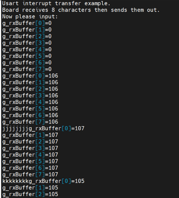

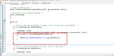

You can add these code to print receives buffer.
for (uint8_t i =0;i<ECHO_BUFFER_LENGTH;i++)
PRINTF("g_rxBuffer[%d]=%d\r\n",i,g_rxBuffer[i]);
You can refer to the picture.
And The output of the serial port is shown in the figure.

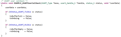

Q2:
The
EXAMPLE_USARTUserCallback
function is the interrupt call back function.
When an interrupt is triggered, it will enter the callback function.
Hope this will help you.
