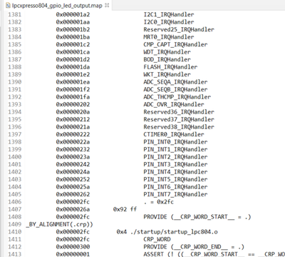

Hello bhavind,
If your project start from 0x00002000, I don't think you can add anything in 0x00002100, because
it over write vector table, you can see .map file the real memory used:
And there is no image header in LPC804 boot flow, why did you want to add it ?
Alice
