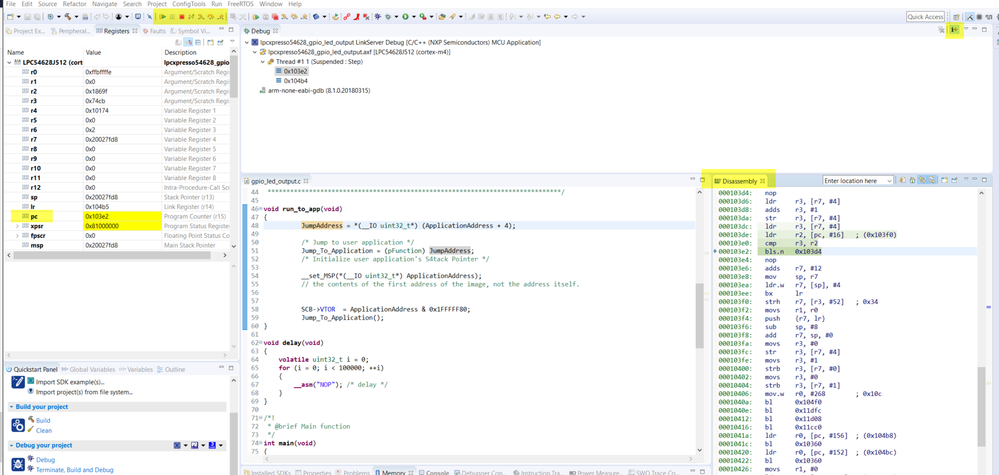

Hi, i have the following problem with a secondary bootloader in LPC54608 custom board. It is very similar to evaluation kit OM13092.
If i load the application program to the address 0x8000 with the JFlash program and later load the bootloader to the 0x0 address, after the reset the secondary bootloader jump to the application program and work OK.
But if the secondary bootloader load the aplication program from SPIFI to RAM and then to flash address 0x8000, after reset the secondary bootloader jump to the application program but it does not work properly ( hard fault ).
We compare how the flash (address 0 to 0x7ffff) is after being recorded, by the jflash and by the secondary bootloader and there are no differences.
If run the application program from address 0x0 ( without secondary bootloader) work OK.
The only way that works is to delete everything with the JFlash, load the application in 0x8000 and then the bootloader.
that could be happening?

Hello miguel,
1) "But if the secondary bootloader load the aplication program from SPIFI to RAM and then to flash address 0x8000, "
-> After this , compare the data from 0x8000 with hex file of application , they are should be the same.
2) "If i load the application program to the address 0x8000 with the JFlash program and later load the bootloader to the 0x0 address, after the reset the secondary bootloader jump to the application program and work OK."
-> Do you meaning, when use JFlash  flashing Appplicaiton and bootloader, bootloader can jump to APP, APP also can work well ? When using using bootloader get APP code , the flash it to ox8000, it can't work ? If yes, I think you need check 0x8000 memory as 1).
3) "It is possible to debug the application once the bootloader jumps to it, from the debugger? ", can debug Disassembly
code :
This can Check whether it jump to 0x8000 successfully.
TIC
