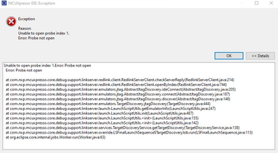

"Unable to open probe index 1. Error: Probe not open" error on LPC55S69
9,312 Views
Khosoo

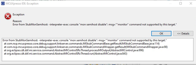

Inserted error snipped bottom of this. Is there any solution that i can connect my MC to MCUxpresso.
MCUXpresso Version : MCUXpresso IDE v11.4.1 [Build 6260] [2021-09-15]

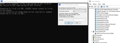

On my side, I solved this problem by
1 - Going to Windows Device Manager,
2 - find under USB devices the MCU-LINK (r0FF) CMSIS-DAP V3.108,
3 - Right click on it,
4 - Click on Uninstall peripheral,
5 - Unplug the USB cable,
6 - Plug again the USB cable,
It will reinstall itself and it will work !

Update: The main problem is it can find the probe but can't connect to it. Error is still there, but there is a time I can connect to the board from my pc. The walkthrough is like this:
  1. Connect the board to PC and power supply
  2. Start MCUXpresso and start debugging
  3. Open probe error will occur
  4. Close MCUXpresso and every open application
  5. Restart your PC
    1. Do not disconnect the board from the PC and power supply.
  6. Open MCUXpresso and connect to the board
  7. It will connect
Is there any solution that I can connect the board normally? Like, not restarting my PC or not closing MCUXPresso.
Have a nice day
Khos-Erdene

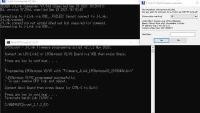

First I installed J-Link firmware and tried again. But there is no change in result.
※Board is on ISP mode
Am I doing it wrong can you see the result?

ZhangJennie

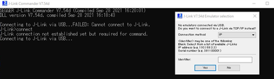

Did you remove DFU  when use Jlink commander to test?
9,229 Views
Khosoo
Yes, I tried removing it & I have done the setting.
But still got the "Probe not open" error on MCUXpresso.
※I removed DFU when I use Jlink commander, and connected it when I tried it on MCUXpresso.
9,212 Views
ZhangJennie
From the screenshot, your PC can identify MCU core with Jink interface but IDE can't identify it.
I suggest you fully uninstall your IDE and SDK (make sure the redundant folders are removed ) then reinstall them again. please use the latest IDE and SDK version.
