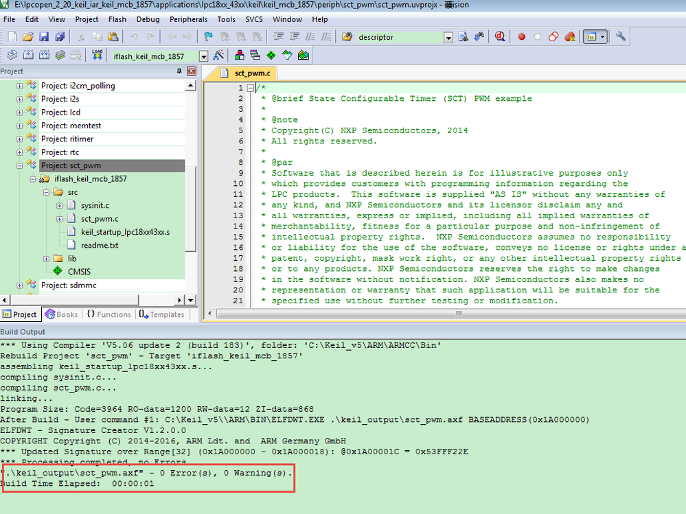

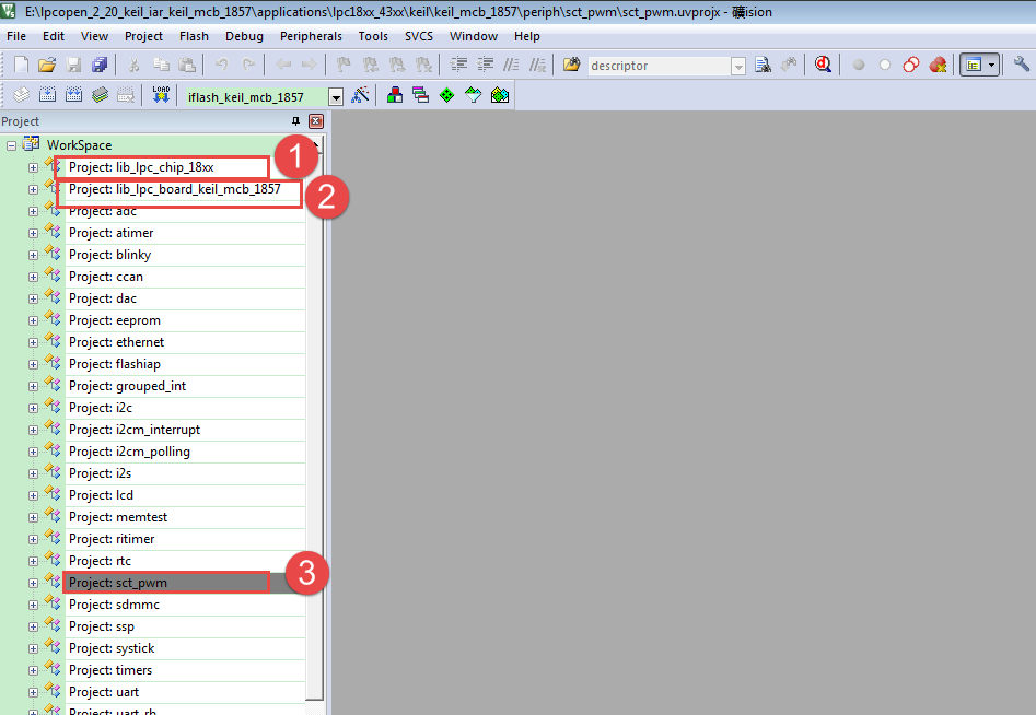

kerryzhou
Hi 9218 sky,
   Please follow my step:
1. open periph_examples in folder:lpcopen_2_20_keil_iar_keil_mcb_1857\applications\lpc18xx_43xx\keil\keil_mcb_1857
2. Build lib_lpc_chip_18xx and lib_lpc_board-keil_mcb_1857 two libs at first:
3
No error.
Wish it helps you!
