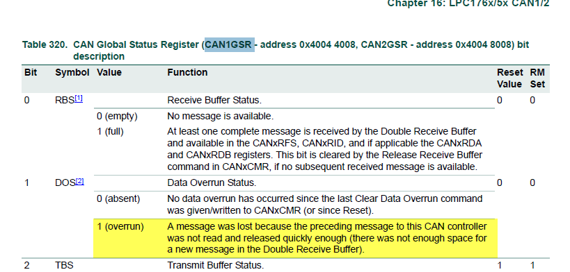

LPC_CAN1->CMR |= (0x01<<2);
LPC_CAN1->IER |= ((1<<0)|(1<<2)|(1<<3)); //接收数据过载中断使能
LPC_CAN1->GSR中的DOS标志置1时,总线上却未发现“过载帧”波形。
我仿真的时候检测can过载帧的标志位,当置位的时候并没有发现有过载帧发出的波形。
1、How do I configure this chip to make the can receiver send an overload frame?
2、an overload frame is send by hardware automatically?

kerryzhou
Hi tongjun,
   CAN1GSR[DOS] is the data overrun status, it is not the overload frame flag.
Overload frame is sent by the hardware automatically, it is not controlled by the user code.
Wish it helps you!

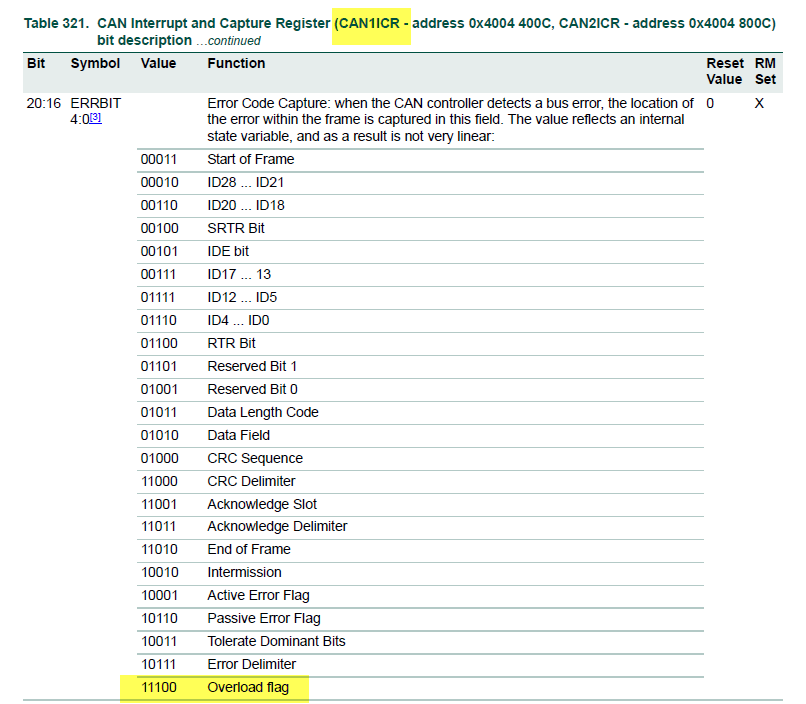

Overload frame is sent by the hardware automatically , How do I know when the overload frame is sent ?
If some value of some registers is changed when the overload frame is sent , What is the name of the register?

kerryzhou
Hi Tongjun,
   1. Give you a picture from the book.
2. overload register
Kerry
