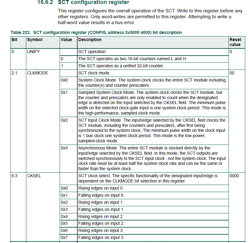

Pls refer to the CONFIG register, for example you can use the one of SCT_PIN[0:3] signal as tick signal, for example, you use SCT_PIN0 signal as tick source, you can set the CONFIG[CLKMODE]=0x3, CONFIG[CKSEL]=0x0 0r 0x1.

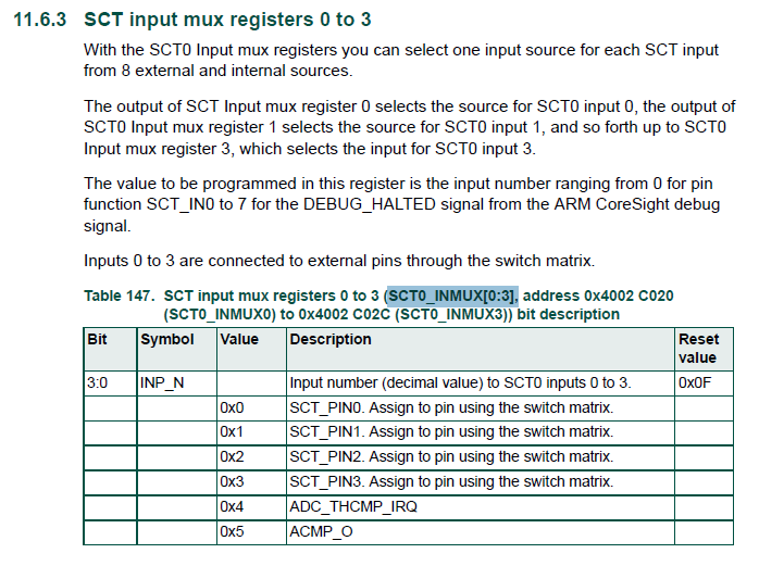

You have to set up the SCT0_INMUX[0] to selcet the SCT_PIN0 by SCT0_INMUX[0]=0x00;

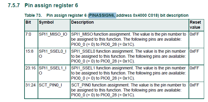

for example, you connect the external clock signal to pin PIO0_7 as SCT0_PIN0 signal, you can write PINASSIGN6=7<<24. it is okay.
