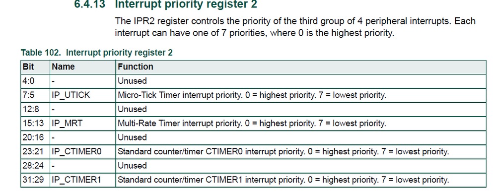

xiangjun_rong
Hi, LiangChen,
As you know that the Cortex-M4 use the follow IPR register format for each external interrupt source:
For example, the interrupt priority of IP_CTIMER0 for LPC546xx are located at bit21~23, it's priority is from 0 to 7(from 3b'000 to 3b'111), the 3b'000 is of highest priority, the 3b'111 is of lowest priority. The configMAX_PRIORITIES is set up as 5 using the line in FreeRtos system:
#define configMAX_PRIORITIES                    5
So for your own peripheral interrupt source, you have to set priority of  your own peripheral interrupt source lower than 5 level. In other words, set the IPR register value greater than 5. For example, you want to use IP_TIMER0 module interrupt, and post an event, so you have to set up the IP_CTIMER0 bits(bit21~23) for example 6, 3b'110, it is okay.
Hope it can help you
XiangJun Rong
