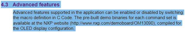

Hi everyone,
I just ordered a LPC54114 audio and voice recognition kit. But it seems the pre-loaded software with the kit does not have audio and voice recognition function.

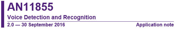

From NXP website, I download the application not, it says:
I just could not find the pre-built demo binaries software on the given location.
Could anyone here to tell me where I can find this pre-built demo binaries software in NXP website, so I can simply download and run the demo.
Thanks in the help!
Xiaowei

Hi Zhang
A demo running on the LPC54114 audio and voice kit (order code OM13090).
This demo shows a system detecting the wake up phrase “Hello Blue Genie”, followed by five other phrases: “Make it so”, “Blink LED”, “Flash display”, “Sensory logo” and “NXP logo”. The demo delivered as a binary file that can be programmed onto the OM13090 board set using a simple drag and drop process.
See attached
