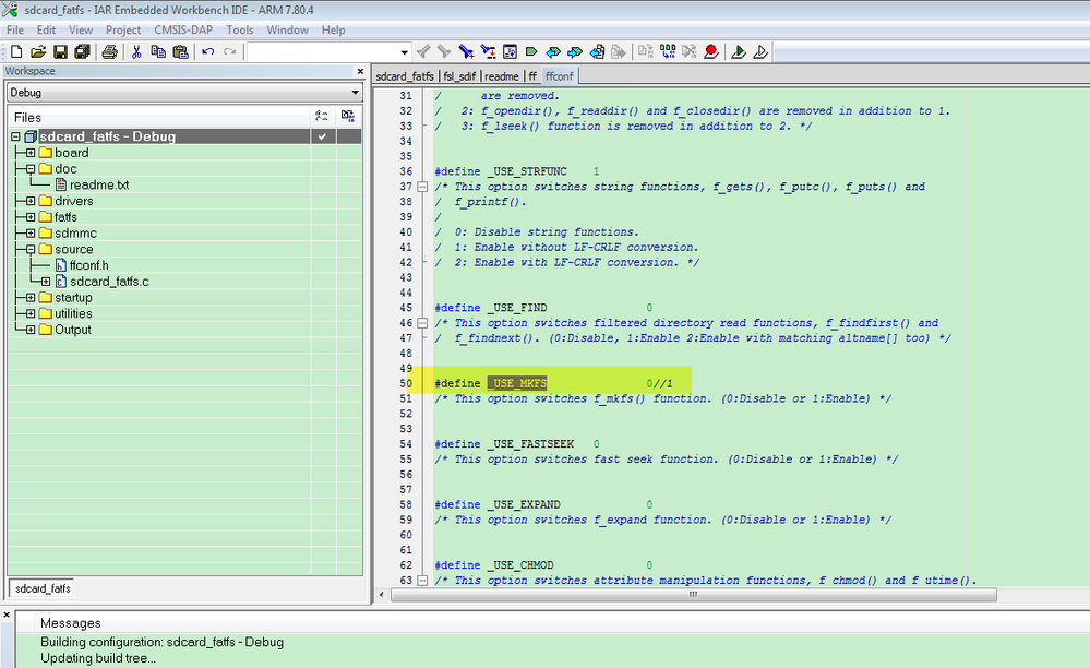

    Just do this modification:
1. open ffconf.h
   Line 50, change _USE_MKFS to 0.
Disable f_mkfs function

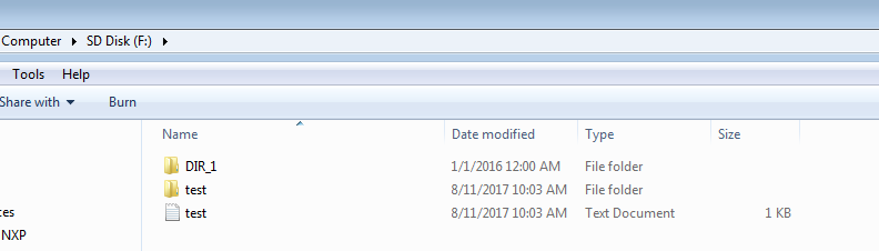

2. New test result
  This is my test result in the SD card.
After point 1 modification, build and download it to the board again.
You can find the folder test and test.txt still exist.
1. open ffconf.h
2. New test result
