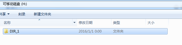

When I was doing this demo, I created the file in SD card,  both DIR1 and DIR2 succeeded, but wiped out all the files in my SD card. What's the reason for this? Is there a way not to erase?

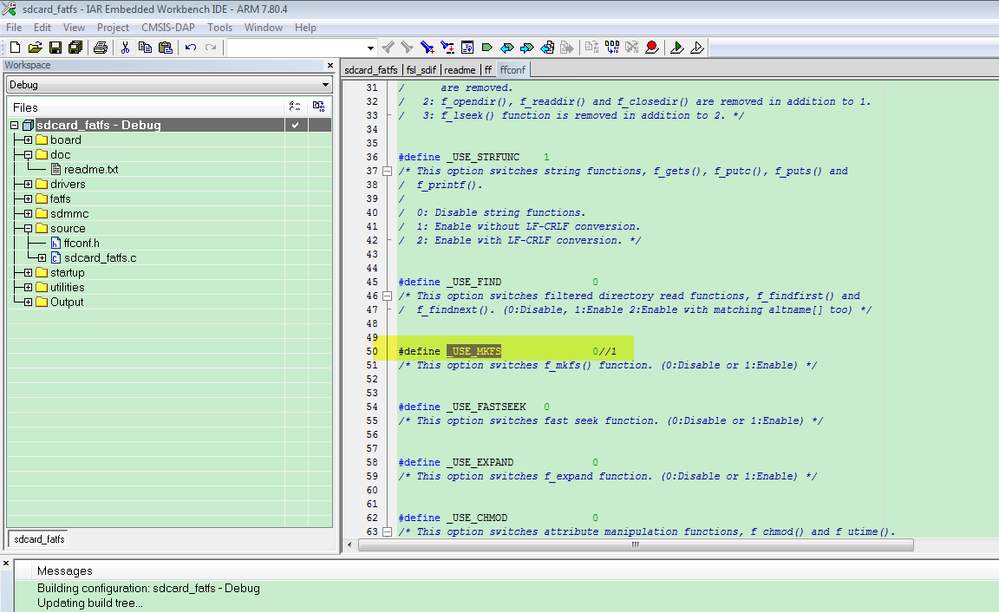

    Just do this modification:
1. open ffconf.h
   Line 50, change _USE_MKFS to 0.
Disable f_mkfs function

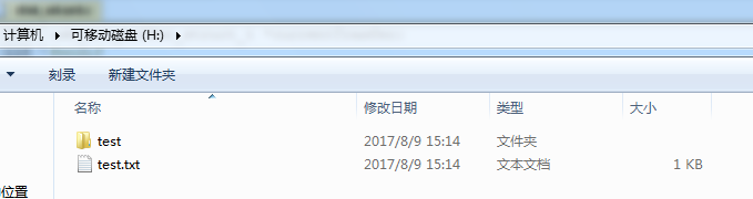

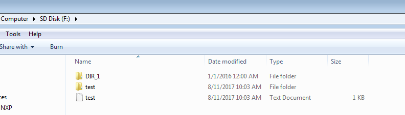

2. New test result
  This is my test result in the SD card.
After point 1 modification, build and download it to the board again.
You can find the folder test and test.txt still exist.
You can try it on your side.

zhixiangzeng
Hi,there are  1 file and 1 folder  existed my SD card .When after I run the examples "SDK_2.2_LPC54608J512\boards\lpcxpresso54608\driver_examples\sdcard_fatfs",the  both DIR1 and DIR2 succeeded123.png
but  the file test and folder test have been erased.There are only the DIR_1 created by the fatfs.
1. open ffconf.h
2. New test result

zhixiangzeng
Hi,Kerry!
       I have solved the problem last night, and the modifications I made were the same as you mentioned. Anyway, thank you very much for your support.
