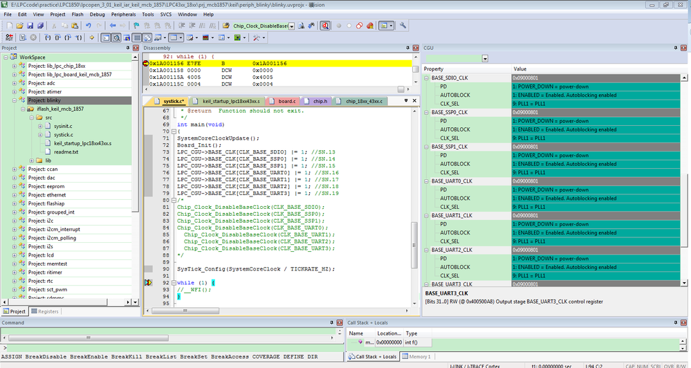

9218sky
Hi kerry
problem generation from "systick" project main file add some close base-clock code only.
IDE for MDK51X
MCU LPC1833JDB144(I designe small system board)
1. sample pack "lpcopen_3_01_keil_iar_keil_mcb_1857"
2. edit peripheral "lpcopen_3_01_keil_iar_keil_mcb_1857\LPC43xx_18xx\prj_mcb1857\keil\periph_systick"
main file, as follow:
int main(void)
LPC_CGU->BASE_CLK[CLK_BASE_SDIO] |= 1; //SN.13
LPC_CGU->BASE_CLK[CLK_BASE_SSP0] |= 1; //SN.14
LPC_CGU->BASE_CLK[CLK_BASE_SSP1] |= 1; //SN.15
LPC_CGU->BASE_CLK[CLK_BASE_UART0] |= 1; //SN.16
LPC_CGU->BASE_CLK[CLK_BASE_UART1] |= 1; //SN.17
LPC_CGU->BASE_CLK[CLK_BASE_UART2] |= 1; //SN.18
LPC_CGU->BASE_CLK[CLK_BASE_UART3] |= 1; //SN.19
SystemCoreClockUpdate();
Board_Init();
/* Enable and setup SysTick Timer at a periodic rate */
SysTick_Config(SystemCoreClock / TICKRATE_HZ);
while (1) {
__WFI();
3. other file not change!
4. build the project and debug, MDK display as follow:20170509-1.jpg20170509-2.jpg
best regard!
sky9218

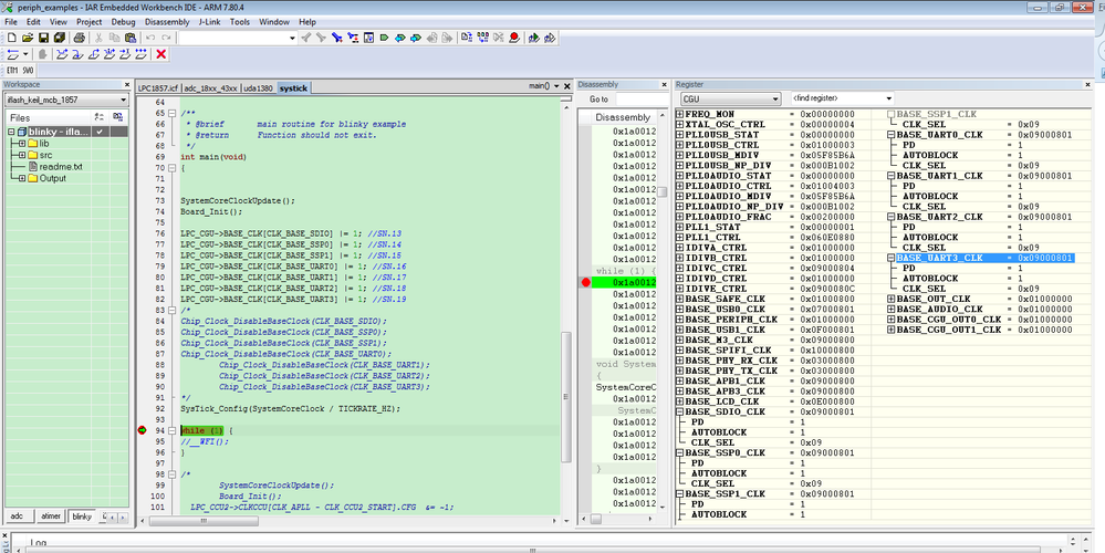

kerryzhou
Hi 9218 sky,
     Thank you for your more details.
     I have tried the MDK systick project on my side, that's really strange for the MDK IDE. In the MDK IDE project debug mode, I have reflect your problem.
     But, I find the blinky project which is the same source code as systick, this project don't have problem.
    Besides, when I use the IAR project, both blink and systick ,  and in debug mode, no problem happens.
The code you can used like me:
int main(void)
Board_Init();
Chip_Clock_DisableBaseClock(CLK_BASE_SDIO);
Chip_Clock_DisableBaseClock(CLK_BASE_SSP0);
Chip_Clock_DisableBaseClock(CLK_BASE_SSP1);
Chip_Clock_DisableBaseClock(CLK_BASE_UART0);
    Chip_Clock_DisableBaseClock(CLK_BASE_UART1);
    Chip_Clock_DisableBaseClock(CLK_BASE_UART2);
    Chip_Clock_DisableBaseClock(CLK_BASE_UART3);
while (1) {
//__WFI();// in debug mode, must comment
You can try the blink project, or the IAR according project on your side.
Your problem should caused by the systick MDK project creation. Chip function have no problem.
Wish it helps you!
Kerry
