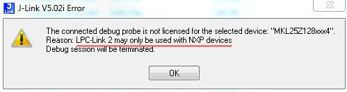

I'm not sure what the current status of Kinetis rather than LPC part support is in the Segger J-Link LPC-Link2 image is, but will check into this. But for general information on the use of the LPC-Link2 J-Link image, please visit SEGGER - The Embedded Experts - LPC Link 2

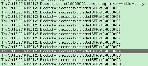

I've also LPC-Link2 when using the CMSIS-DAP firmware to debug the Kinetis MCU, it also break down.

The LPC-Link2 only be used with NXP devices, I've also had a testing.
