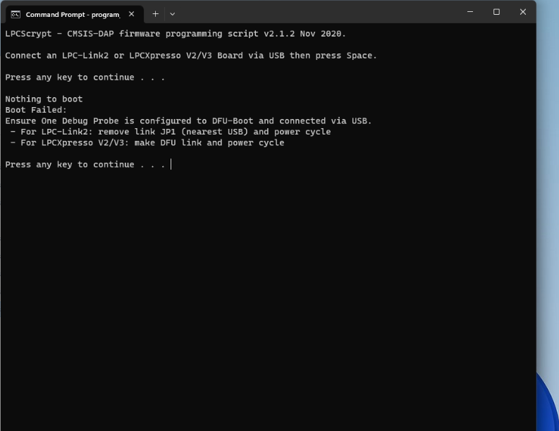

ZJane
I tried LPCScrypt, the device cannot be  found.

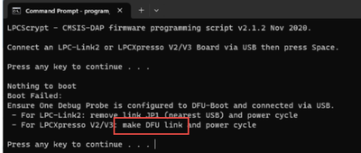

Hello @ZJane
Make sure your board make DFU link as description,  it also mean short 1-2 of JP6 on LPCXpresso4337 board.

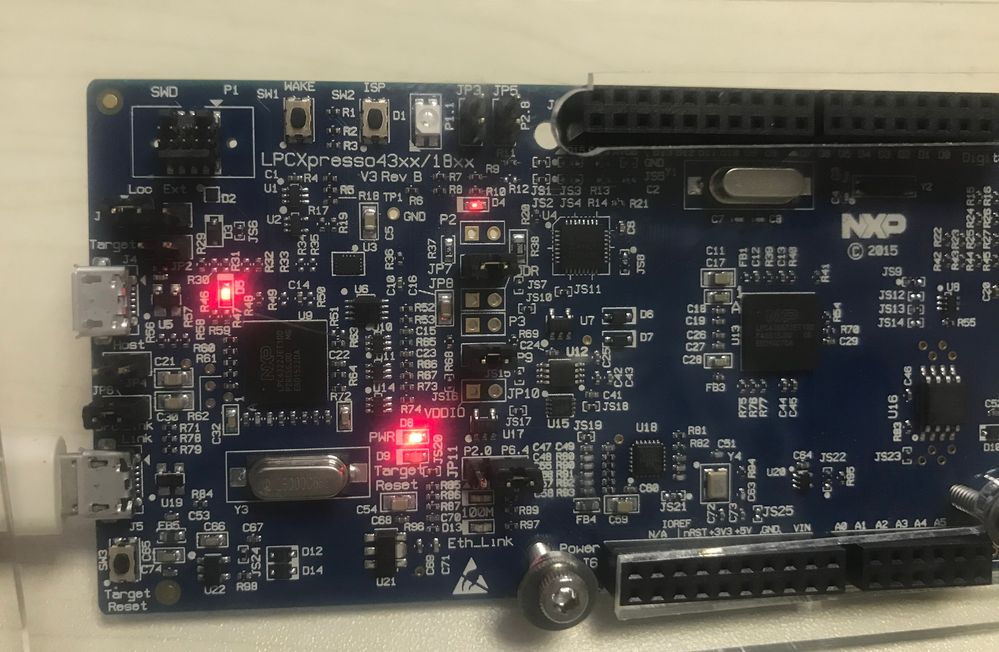

ZJane
yes, the board make DFU link and connec a micro USB cable to connector J5.

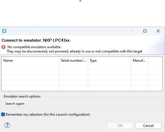

ZJane
You can see the error and board connection in the picture below.

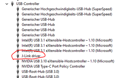

You are not by chance using VMs, and forgot to connect USB device(s) forth and back between host and VM ?
Here an example of a connected STM eval board, with the integrated debugger reflashed to a Segger J-Link:
