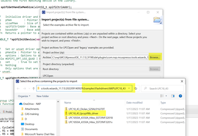

Hello @mathewcigi
You can download LPC SPIFI library from:
https://www.nxp.com/products/processors-and-microcontrollers/arm-microcontrollers/general-purpose-mc...
Also can find under MCUXpresso IDE if you installed:
