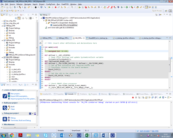

The model for multicore debug is that the Master (linked) project programs the code and data for all cores - therefore this will be 'Debugged' first and the M0 cores must only be 'Attached'.
Care must be taken with a number of issues.
Be sure to connect the appropriate projects to the required cores (over JTAG) for this device.
The M4 core is automatically selected by the IDE when a debug operation is performed. This operation will program all the required code to flash. RAM code as used by the M0Sub is placed by the M4 start up sequence - Therefore I recommend that the M4 project is run once it has been programmed.
The M0 Sub has to be manually selected the first time (as below) - this setting will be remembered inside the projects build configuration folder.
Once the the M4 project has been run, and the M0 sub attached, you can pause the M0 sub and see it running at the correct (expected) address.
You will also see the automatically created launch configuration for the M0Sub set to show it will attach on 'Debug' via the 'A' decorator (shown below).
The remaining M0App project will automatically select the remaining M0 core. You can then attach this and run and pause all of the projects (together or singly) and see something like below:
Step within this debug stack to see scope and core displayed in the various debug views.

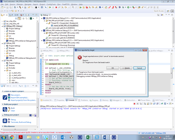

Then I Reset the controller and then click on debug icon and it got programmed. The I tried to programme M0Sub project and I got this error.
I don’t understand why it gives this error shown below.
“  15: Target error from Set break/watch
  Unable to set an execution break - no resource available.
  Debugging context: M0Sub_FPR LinkServer Debug”

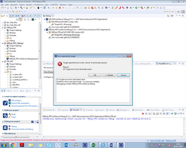

Then I clicked to cancel to terminate the session. Then it terminates both M4 and M0Sub session. Again initiated to debug the M4 Project and I got below error,
Again I need to do Mass erase using GUI flash tool to reinitiate debugging, Then the M4 Project was programmed.
Then initiated to launch debug for M0Sub Project. And it got programmed
Then I initiated to launch debug for M0App Project. Then I got the same error again,
Now this time it is for M0App project and every time when this error comes and I click on OK ot goes to ResetISR(void) function of M0App Project.
Again I need to do Mass erase using GUI flash tool to reinitiate debugging for all the Projects.
I am able to programme M4 Project but while launching M0Sub project it again gives error
Now this is a random behaviour since sometimes it comes for M0App and sometimes it comes for M0Sub but for M4 Project it gets launched successfully every time. when I click on OK to goes to ResetISR(void) function of M0Sub / M0AppProject.

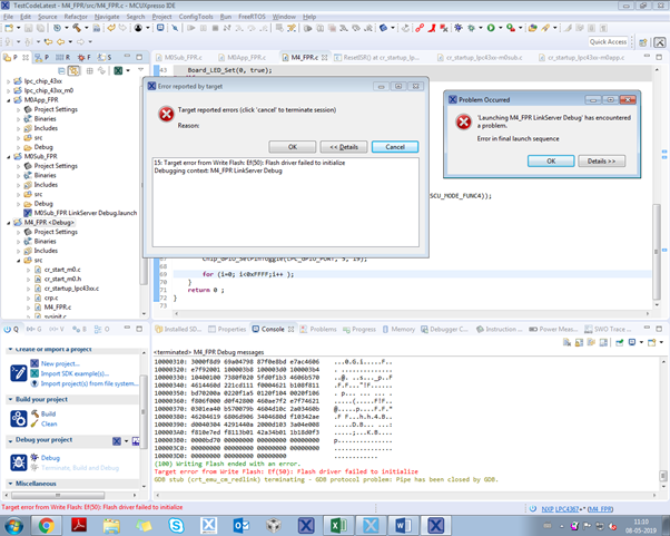

After the compilation I choose M4_FRR project to download and debug. But while doing the same I faced following error and  I was not able to download and debug.
You can see I was not able to program and it got stuck. This behaviour is observerd for both the board (Development board and Eval board OM13088). To come out of this condition I clicked on "TerminateBuildandDebug" option. After clicking of this option I got following error.
You can see that the MCUxpresso IDE was unable to detect M4 core. Again this is the same observation in both the boards (Development board and Eval board OM13088). Then to over come this I clicked on "Clean up Debug " option and again reinitiate to download and debug M4_FRR project. Then I got the folowwing error.
You can see that "Target error from flash write Ef(50)" occurs. So I deleted the debug and launch and did cleaned the build the project again and initiate to download and debug M4_FRR project. I was not able to down load and debug and  got follwing error.
You can see    "Target error from flash write Ef(50)" occurs again. Then  I tried with LPCXpresso as well but same error occurs since there was a corruption in memory. Then as per the Regaining debug access to target MCU  post I performed following operation

When I click on cancel button it terminated all the other cores as well. Again this is the same observation in both the boards (Development board and Eval board OM13088). When I click on ok  (after getting the same error again ) then the M0Sub core  program is in ResetISR function and it is stuck there even if i tried to reset the code by using "move to line" option in debugging mode. After that i again tried to download and debug but then the same error "Target error from flash write Ef(50)" occurs again (mentioned above). One more thing while I was performing the same in LPC eval board  and when tried to reprogram M0Sub core I got following error
Then I did cleanup Debug and deleted the launch and dedug and reprogrammed  but the same error "Target Srror from Set break /watch "
Then i performed the same using LPCxpresso IDE and there everything works fine.
While downloading using MCUXpresso in case of Eval board I was able to reprogram but then while loading M0App _FPR project it gives follwong popup but i was able to debug.
I clciked ok and proceed further but when started downloading the M0Sub_FPR project then again the following error ocurs
I case of LPC expresso I was able program download and debug all the time. So over all I can see that there is a problem with the MCU Xpresso while dowloading the program for the first time, while Downloading third core (M0App / M0Sub). I tried by clicking on Skip all break point opting  doubting that there migh be more breakpoint set but atill no success.
I would sugest you to do the same opertion and download and debug all the three cores since in you mentioned feedback above you have only M4_FPR project. Download and debug others as well with the same tescode project I shared already.
