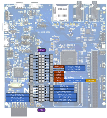

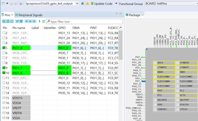

I have a question regarding the usage of GPIOs of the LPCXpresso55S69 board. I have trouble finding an explanation/a picture, which GPIO routs to which output pin. Meaning, that I found the "Pins" View in the SDK:

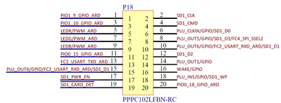

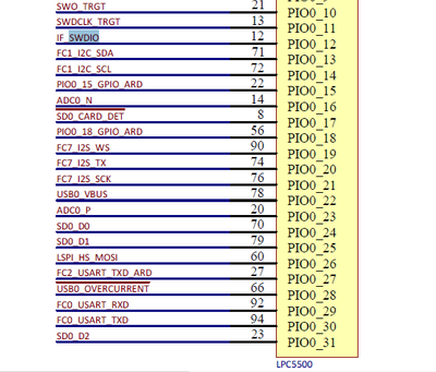

 But how do I know where e.g. PIO0_12 is on the board? I have found those two pictures, which are not helpful at all, because they don't use the same naming. So, where do I have to put my cable on my board if I want to attach it to e.g. PIO0_12? Where do I find this information? Or am I just too stupid to understand those pictures?

Hi Ximena,
I check P18 connector, there are also other GPIO pins connected. For example  PIO1_9, PIO1_10, PIO1_15, PIO1_18.
some of them are defined as input buttons. but you can also config it as gpio output.
For more see demo board UM and Schematic.

PIO0_12 is routed as SWDIO, but not PIO0_12 for LPCXpresso55S65 board.
It's not routed to P17 or P18

If you just want to test GPIO feature, LPCXpresso55S69 board provides P1_4, P1_6 and P1_7 for it.
The LEDs in this device are controlled by LPC55Sxx ports P1_4 (Blue), P1_6 (Red), P1_7
(Green) with the LEDs being illuminated when the respective LED is pulled low. Note that
these port lines are also connected to expansion connector P18.
You can check it with SDK demo code gpio_led_output. Here is pin configuration:

Hi Ximena,
