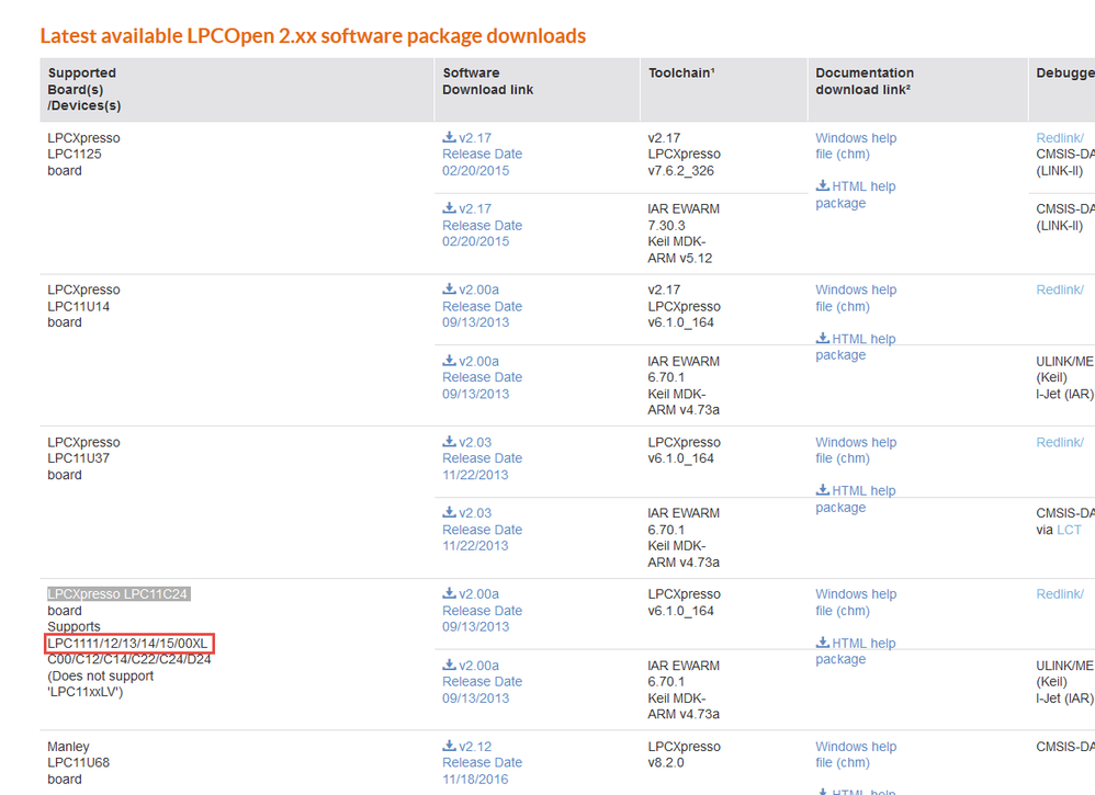

The latest available LPCOpen 2.xx software package downloads include packages for:
LPC1125 (112x series)
LPC11U14 (U series)
LPC11U37 (U series)
LPC11C24 (C series)
LPC11U68 (U series)
LPC11E68 (E series)
Why is there no download for the plain 11xx series, e.g. the LPC1114?
The organization of the new LPCOpen software is extremely confusing compared to the old CMSIS drivers. Back in the CMSIS days, there was a single release of the CMSIS core, which had a dozen subdirectories -- one for each chip series (including the LPC11xx).
The new LPCOpen is a mishmash of different releases at different dates with different version numbers, each of which only supports a single release and is tied to a particular target board. Shouldn't it be possible to download a single package that has the latest version of the support for each chip series, as the CMSIS drivers did?

Hi a b,
   About the LPC1114 code, except the cmsis drivers,  code bundle code which can be downloaded from Floor 4.
   You also can refer to the LPCopen code for LPCXpresso LPC11C24 :
LPCOpen Software for LPC11XX|NXP
Wish it helps you!
If you still have question, please let me know!
Kerry

I have landed here with the same question. I'm looking for LPC1114 firmware for baremetal programming, but I find the supported devices in the header files are (see  lpcopen_v2_00a_lpcxpresso_nxp_lpcxpresso_11c24/lpc_chip_11cxx_lib/inc/chip.h):
CHIP_LPC110x/
CHIP_LPC11XXLV/
CHIP_LPC11AXX/
CHIP_LPC11CXX/
CHIP_LPC11EXX/
CHIP_LPC11UXX/
CHIP_LPC1125
So for the LPC1114, I'd expect CHIP_LPC11XX or the like to be present, but it's not there. Which define is the recommended one for the LPC1114?
As a sidenote, I see the driver is v2.00 of 2013, but the release notes don't go back that far.
Rgds Joseph

Hello Joseph Heller,
    The lpcware sample code link already relocate to the lpcopen website.
    You can refer to my attached code bundle code, it can support the lpc1114.
Wish it helps you!
Kerry
